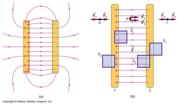

The leaky capacitor is connected to the current source (AC) via two metal electrodes. But How does the conductivity and relative permitivvity play the roles in this scenario?
The "leakiness" of the capacitor does not affect the electric field, unless your AC source has a moderate source impedance. That would lower the voltage across the cap, which would lower the electric field.
As mentioned previously, the E-field in a capacitor is just the voltage divided by the spacing (at least when you are inside the capacitor away from the edges). Can you say more about what you are trying to do and why?

No worries. Do my comments about the source impedance and the Electric field make sense? Can you post a diagram of what you are trying to model?
Anything like this?
http://www.physics.louisville.edu/cldavis/phys299/notes/elec_cap_fig1.jpg
Anything like this?
