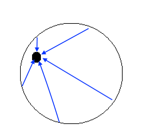

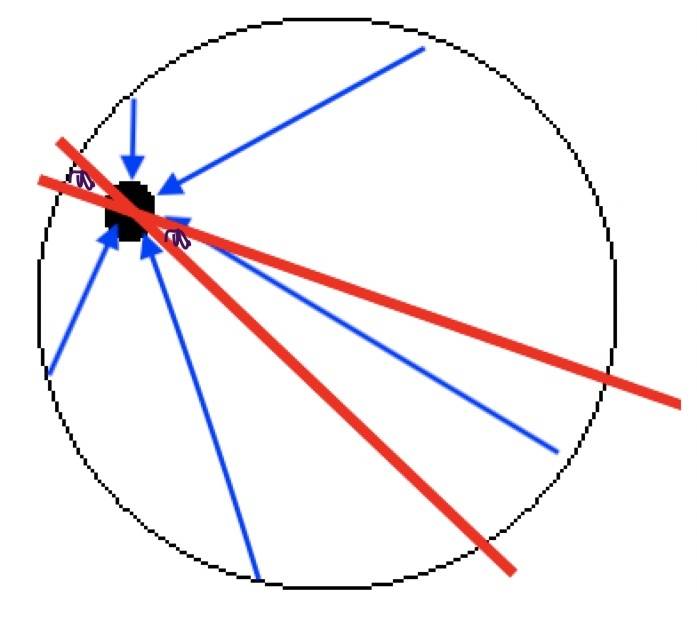

Electric field is 0 in the center of a spherical conductor. At a point P (black dot), I do not understand how the electric field cancels and becomes 0. Electric field is in blue.
Whether the conductor shell hold charge or not and grounded or not, matter.
Gauss's law and spherical symmetry make it zero. But yes if you try to think in terms of the Coulomb's law (like the blue arrows you draw suggest) it is not so obvious.
The intuitive approach to explain it using Coulomb's law is that the part of the conductor that is closest to the point exerts greater electric field but it is smaller in length than the part of the conductor that is furthest apart and hence exerts smaller electric field. The two electric fields cancel out. It is something like $$L_1D_1-L_2D_2=0$$ where ##L_1##,##L_2## the lengths of the bigger and smaller part and ##D_1## and ##D_2## the influence of the bigger and smaller part. The bigger part has smaller influence and the smaller part has bigger influence. So it is ##L_1>L_2## but ##D_1<D_2##. All these are very intuitive though, if you want a formal treatment of this using coulomb's law you have to do a hard integral to prove that it is zero at any point in the interior of the sphere.

What do your D's stand for. The electric field of the smaller length is greater than the electric field of the greater length, so there should be a net positive electric field...Not sure how they cancel out.
First of all my treatment is very intuitive. My D's stand for something like average electric field (generated by ) per unit length of charge density. The average electric field per unit length of the smaller part is greater (than the electric field per unit length of the biggest part) because the smaller part is closer to the point so by the inverse square law generates bigger electric field.
Your logic is flawed here. If you consider a small solid angle in one direction and the opposite direction, the amount of charge within that solid angle will be smaller for the closer side and larger for the farther side so there is simply more charge on the farther side. This exactly cancels the charges closer giving a larger contribution per unit charge.

I don't understand why the densities D would not be the same...
It is not about the surface density. It is about the amount of charge per solid angle.

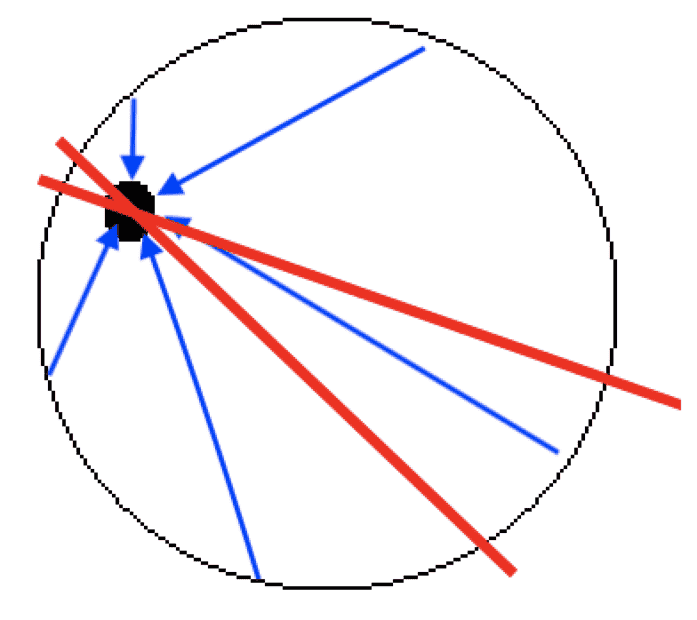

Here is an illustration I quickly put together using the picture from your OP by adding two red lines:
As you can see, there is a lot more charge between the red lines to the right than to the left, yet this is what represents the opposite direction of the charge between the red lines to the left. This effect is what exactly cancels the closer charges giving more field strength per charge.
This makes sense for a hollow spherical charge. But is this true for a solid spherical charge?
It seems like for a solid spherical charge, there is more electrical field on the right side.
Which the shell theorem confirms nicely. The portion of a [spherically symmetric] charge distribution closer to the center than to the test point contributes to the field as if that portion of the total charge were concentrated in the center.

There is no charge within the red lines. They have width zero. It is just impossible to draw with width zero.
