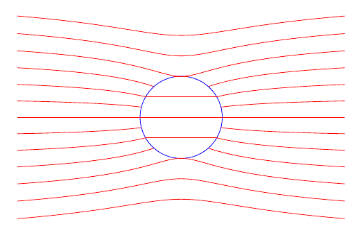

I need to draw electric field lines of sphere in uniform electric field with LaTeX/TikZ. Can anyone show me equation of field lines in polar coordinates?

Is this an uncharged conducting sphere? If so, why the field lines inside it, and what direction should the field lines be at the external surface?
Is the uncharged dielectric sphere. I found some equation
##r = \frac{k - \sin\phi}{E_0\sin\phi}## and plot the lines:

I get
Ok, so it is not a conductor. Looks reasonable, except that I am not sure what the figure of eight inside the sphere represents, or what the field lines are doing there.

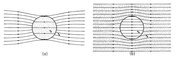

Yes, the same equation would not apply inside. For lines inside I just draw series of parallel lines.
What is the basis for making them parallel inside? Surely those would be distorted by what is going on outside. There is a symmetry here.
Parallel lines inside is because fileld inside sphere (as well as for every "ellipsoid-like" body) is uniform. It uniform because charge distribution around surface is ##\sigma \propto \cos\phi##. Such distribution governing by boundary conditions and supperppsition of external uniform field and dipole field of sphere.
You still have not clearly specified the problem. You have explained that the sphere contains dielectric material, but why should there be a surface charge as you describe? If it is a conductor there is no field inside; if an insulator why should there be a surface charge distribution?
Or maybe I am just out of my depth.
Oh, sorry I forgetting to say, the dielectric sphere has the susceptibility ##\epsilon_2## differ from susceptibility of media ##\epsilon_1##, thus there is associated charges on the sphere (due to polarization)
##\sigma' = \frac{3}{4\pi} \frac{\epsilon_1 - \epsilon_2}{\epsilon_1 + 2\epsilon_2} \frac{\vec E_0\vec{r}}{R}.##
Of course, if ##\epsilon_2 =\epsilon_1## there is no charges around sphere.
The field inside sphere is ##E =\frac{3\epsilon_2}{\epsilon_2 + 2\epsilon_1}E_0##
