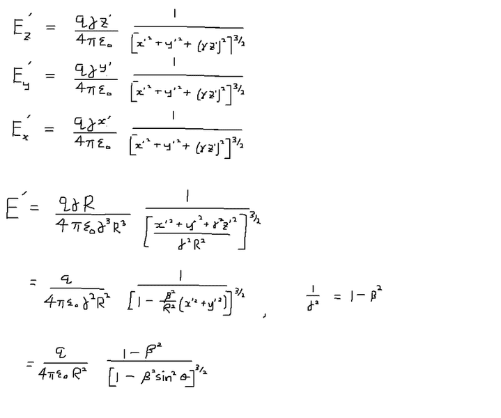

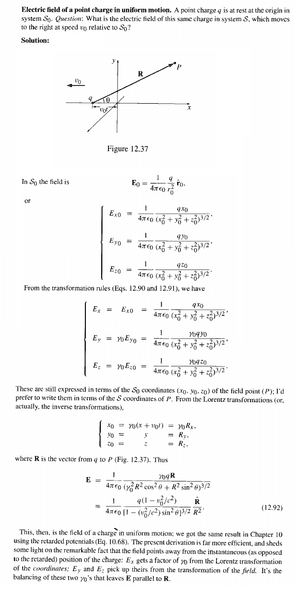

In Griffiths Chapter 12, pg 527:
Suppose a point charge is moving along x, we obtain the following E-fields:
Questions
1. Is the vector R solely in the x-y plane?
2. What happened to the coordinate 'z' ?
3. Why are they only doing things in the 2-D plane? Can we use rotational symmetry somewhere?
When instead, I assume the particle to be moving along z-axis it fixes everything!
and i use x=Rsinθcosø, y = Rsinθsinø, z = R cos ø
The end result turns out beautifully to be the one as described, in 3 dimensions:
I suspect that since Polar coordinates is usually defined with θ as angle between R and z-axis and ø as angle in x-y plane, everything matches.
