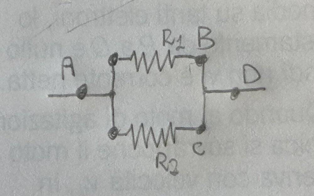

So, having two parallel resistor ##R_{1}## and ##R_{2}## , the current flowing through the equivalent one will be ##I_{eq}=I_{1}+I_{2}##.
Now, it comes the point I'm not totally getting: why is ##V_{eq}=V_{1}=V_{2}##? These V's are the difference of potential measured between which points?
Hand-drawn circuit of two resistors R1 and R2 in parallel between nodes A and D, with R1 on the upper branch ending at B and R2 on the lower branch ending at C, and B and C joined to node D.referring to this ugly image representing the two parallel resistors:
is ##V_{1}=V_{B}-V_{A}## or ##V_{1}=V_{D}-V_{A}##? Or, is ##V_{B}-V_{D}## since they're in the same conductor?
As you can see, I think I haven't clear how does potential varies after that current passes through a resistor.
Look at the circuit. By convention the straight pieces connecting the resistors (wiggly lines) are equipotentials. This means that the potential difference between any two points, which have no circuit element between them, are at the same potential.
So, in this case, ##B## and ##C##(?)
Yes, and also D. You have VAB = VAC = VAD.
Got it, thanks!
