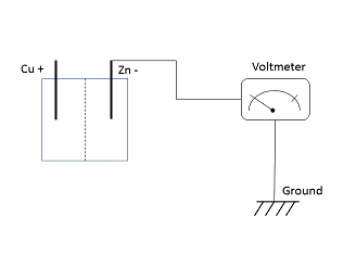

This is the basic schema we are discussing about using for instance a simple Daniell cell. Up to now we have defined no electrical model for it...can you propose one ?
Ok, that diagram just confirms previous comments by others and myself, there will be no current flow to GND
Now change it to this configuration and it's a whole different story

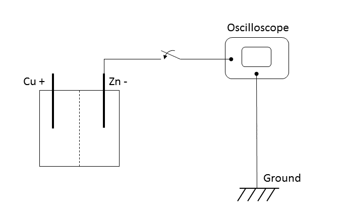

Thus, just to check my understanding, the following two cases are actually different.
242187
In the first case (A) at the given moment conductor 2 (basically a plate of a capacitor) is grounded positive charges discharge towards Earth (or in equivalent way electrons from the Earth neutralize them) whereas in the second case (B) electrons on plate 2 do not discharge because of the "attraction/electrostatic induction" due to positive charges existing on plate 1. In any case electric potential of plate 2 reaches the same as Earth.
Does it make sense ?
You are not going to get case A for the very reasons I stated in my previous post
you are not going to get + and - charges on the same terminal like that ...
the charge there is going to be equal and opposite to what ever is on the other terminal ... period

ok, as advised I re-drew the pictures as follows:
242193
Case A is just to help reasoning and does not represent the original scenario.
We can conclude that, upon turning on the switch, instantaneously the voltage difference between the plate and Ground will drop to 0 (as in the case there was a voltmeter inserted in series with the switch: upon switching it on instantaneously the initial difference voltage would drop to 0 too)
