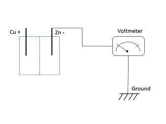

Simple schema, there is no close electrical path: voltmeter probes are connected one to the + battery clamp and the other one to the ground.
My concern was related to the fact that, as others said, thanks to the separation of the charges the + pole should assume a non-zero electric potential respect to the Earth

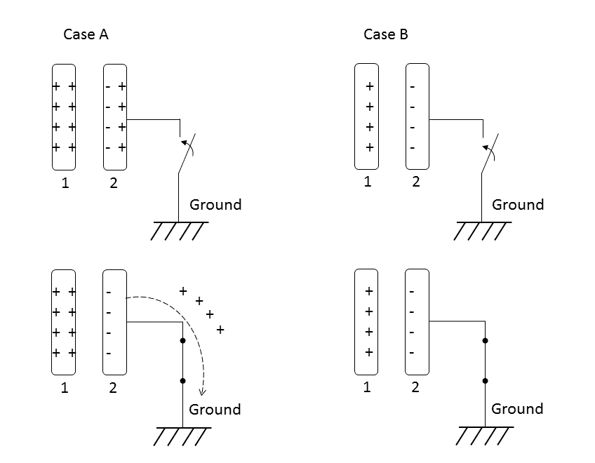

I just tried to think logically. I think there is only one kind of electricity. I also believe that I may not be right, I just don't know the reason. I don't understand what is the chemical potential?
But it can be very confusing for folks like the OP when you make replies that are so incorrect.

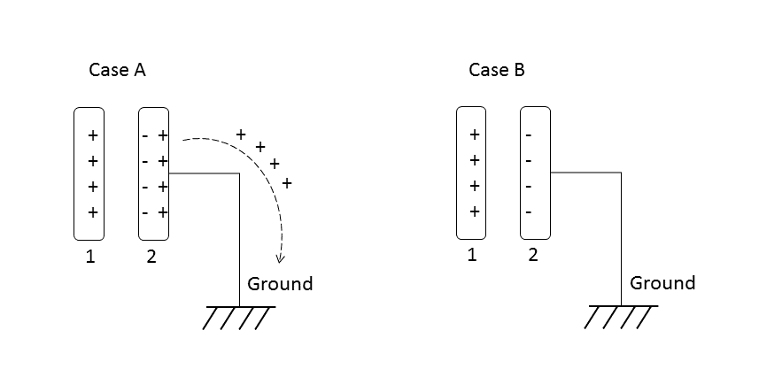

I was undoubtedly wrong, but my idea was just a thought experiment, and anyway, I hadn't read such things for a long time.
However, with that, an electrostatic potential-difference exists and a distinct chemical potential difference, I totally disagree.
The only thing here is that as long as the two metals are not connected by a wire, the chemical processes that produce the potential difference will not start. However, there is only one kind of potential difference.

Thus we end up there exist an electric potential difference between the two battery electrodes (it basically equals the battery emf when the external conductive circuit is open) and the "source" for the electric field inside it is due basically to an excess of charges located onto the electrodes themselves.

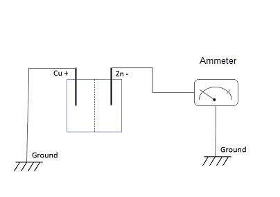

Come back to the original question and consider for instance the battery negative pole. If there exist an excess of electrons on it (even if, as said before, the overall battery net charge is nevertheless zero) why the meter connected between it and the ground (Earth) will not flow any current through it measuring a non-zero voltage ?
If the meter allows any current to flow at all then that terminal will end up at Earth Potential and the other terminal will be above or below 0, depending on which terminal has been grounded.
But, before any connection has been made, the mean potential of the battery is totally unknown.
Your problem seems to be that you are mixing real and ideal situations in your question (and your thinking?)
The meter (voltmeter) has an high impedance nevertheless it allows current to flow. Thus, connecting it for instance between battery negative pole and the ground, I believe the excess electrons on the negative electrode will flow though the voltmeter towards the ground (we assume Earth basically is able to absorb or "pump" electrons without changing its potential). It that is true why it will not measure any voltage ?
