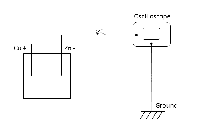

I apologize if I am not able to explain the point or my English is not so good. About the initial conditions: to me they look clear as depicted again in the following picture:
If you prefer this time the instrument is an oscilloscope having let's say 100 Mohm input impedance and the battery is just a Daniell cell (emf 1.10V). Which other initial conditions are needed to describe what happens upon turning on the switch ? I believe the point here is that, up to now, we have not a definitive model for it (for instance which is the model to include the capacitance involved ?)

You just made my point here. If you ‘turn on a switch’ you do not have a DC situation. You do not need to specify the measuring instrument. They all have a similar input stage, in any case, these days.
The potential is whatever it started off as (arbitrary). If you discharge by connecting via any conductance. The potential of the connected terminal will be 0V eventually.
Why are you getting so specific about the equipment and battery and why use such a low voltage ( and possibly unavailable) battery. An AA battery would be just as useful.
I am still not sure if you understand that all you are likely to see will depend more on the arbitrary volts that the isolated battery can have acquired as static charge than any PD across the terminals. You seem to want to 'prove something' but any blip you get on the scope will not really prove anything. Also, there could well be some induced AC volts (probably due to the 'scope leads as much as anything). Frankly, it sounds a bit of a nonsense experiment. Experiments with no preparation or prediction, based on some theory tend to be a bit of a waste of time, however entertaining they may be.
