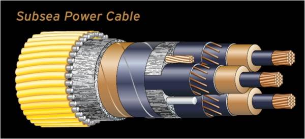

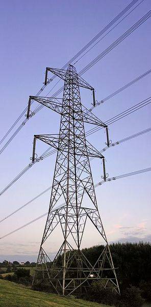

OK, it sounds like you are looking at a power transmission line with three wires well separated. The main reason for the separation is to prevent lightning jumping from one line to another. In other words, insulation.
Underground and underwater power transmission cables use plastics for insulation. But they are expensive, they are limited in voltage, and they have high capacitance which causes problems on the power grid. Therefore they are not used for above ground lines.
So the reason why those wires are not closer together is not just because of materials.
Undersea cable
Overhead power line

@ECO Maverick may also be unaware that the three wires carry electricity in differently phased waveforms, so they cannot actually be combined.
