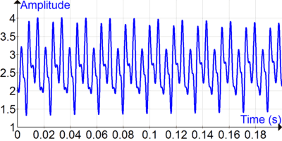

Hi, please help me with the following questions !
can we say that harmonics are because of Reactive Power (i know that one way of controlling harmonics is filtering) ? IF YES, can we control Reactive power by increasing Power Factor ? IF YES it means Harmonics can be controlled by increasing Power Factor ? Does Harmonics occurs by supplying a pure DC current to non linear load ?

two images from it:
here's the waveform of a bass guitar string making a 55 hz A note

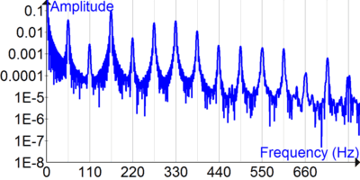

and a plot of its Fourier Analysis
each peak is a harmonic, observe 55hz(first) 110hz(second, and as expected pretty small) 165(third) 220(fourtg) and so on.
That's the simplest concept of harmonics. Deviation from a sinewave and "Dr Fourier's Painless Transform"..
