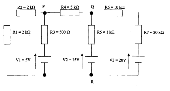

1. For the circuit shown in Figure Q1 calculate:
(i) The magnitude and direction of the current that flows through Rl ,
(H) The magnitude and direction of the current that flows through RS.
(iii) The potential difference between nodes Q and R
(iv) An equivalent circuit between terminals Q and R allowing V3 to be replaced
with a current source.
Circuit has been attactched
Could someone please explain how i would do this question. Thanks
  • Circuit schematic with nodes P, Q and R: R1 = 2 kΩ, R2 = 2 kΩ, R3 = 500 Ω, R4 = 5 kΩ, R5 = 1 kΩ, R6 = 10 kΩ, R7 = 20 kΩ, with sources V1 = 5V, V2 = 15V and V3 = 20V on the bottom rail.
We aren't supposed to just give you the answer.
You have multiple power sources, so start by using the superposition method which means looking at one source at a time and then adding them all up at the end.
Once you've started with that if you need any help, don't hesitate to ask for more.
Hi mate, i didnt want the answer, just some advice/tips on how i should go about doing this question
So do i have to split the circuit into 3 individual ones?
