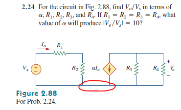

This problem is Problem 2.24 from Fundamentals of Electric Circuits (5th edition).
The problem is as follows:
KVL, KCL

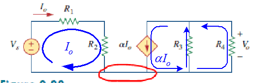

In the official solution, they assume that the total current in the lefthand loop is ##I_o##, whereas the total current in the righthand loop is ##αI_o##. So they say the current flowing through ##R_4## is ##αI_o##. However, if that is true, then at the node that I circled in red wouldn't KCL be violated: ##I_o + αI_o \neq 0## (unless ##α##=-1)?

Can you draw a complete circuit (closed path) for a current passing through that connection?

Reverend Shabazz said:
wouldn't KCL be violated: Io+αIo≠0
That node in red has 4 wires connecting to it. Your equation only has two terms so two are missing.

I would agree with that. Perhaps, then, my contention rises from the assumption that there is no potential gradient between one side vs the other. On the left side, the potential difference between the voltage source and the common ground (the red circled node) is ##V_s##. On the right side, if we assume ##α<0##, the current flows clockwise, and the potential difference between the current source and the ground is, by Ohm's law, ##(αI_o)⋅(\frac {R_3⋅R_4} {R_3+R_4})##. So it would seem only when these two are equal will there be no charge flowing across the "bridge" from one loop to the other.

No (sustained) current will never flow through a path unless there is also a return path. There must be a circuit -- literally a closed path. There is no circuit in this instance. The potential on either side of the connection is the same simply because the wire joins the two sides. Nothing that you hang onto either side can change that unless it provides another path between the two sides and connects at a location with a different potential on at least one of the sides.
The currents in each side of the indicated connection will be totally independent and self-contained.
You could remove the connection entirely and the circuit behavior would be unchanged, although it might cause some consternation for the technician who would have to build completely isolated "floating" power supplies for each side (the circles and diamonds on a circuit diagram conceal a lot of the practicalities of building real sources for circuits :smile: ).

It can't. gneil has given you the best reasons why not but...
Try applying KCL to the voltage source Vs. Io must flow in both terminals. eg out of the +ve and into the -ve terminal. That means Io must flow into and out of the node in the red circle. Similar applies on the right hand side.
So the correct KCL equation for the red node is..
+Io + (-Io) + αIo + (-αIo) = 0
That doesn't look right, not with ##R_3=R_4##.
(Though it may be a reasonable approximation were ##R_3≫R_4##.)
