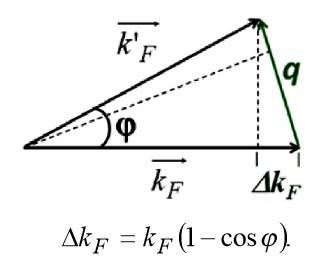

Electron - Phonon scattering, derive the contribution to electron transport.
Trig.
Am I being REALLY stupid here, I can't see how the equation matches the triangle.
If you resolve KF' doesn't KF' cos theta= KF
The only thing I can think is that it's an approximation and delta KF is very small?
Thanks for any help

Yes, I think you're right about ΔKF needing to be small. Also, I think φ needs to be small enough so that cos(φ) ≈ 1 , while (1 - cos(φ) ) can't be ignored.
It looks to me like ΔKF is just a difference in magnitudes of the vectors and not the magnitude of the vector difference.
