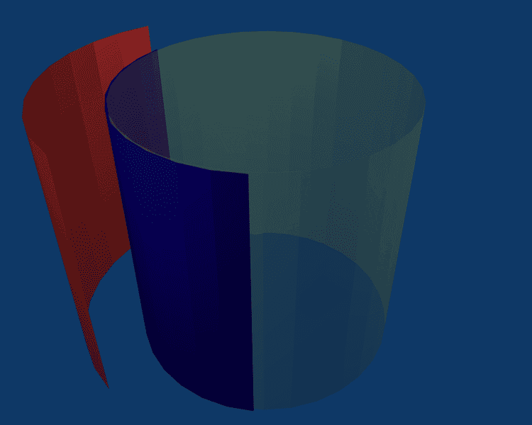

Have a look at the 2 attached images.
There are 2 curves, a red one and a blue one; the red one is fixed while the blue one has the ability to rotate along the surface of the yellow transparent cylinder (or the blue curve forms the locus of the yellow transparent cylinder.).
Both the curves are metallic and the red curve is charged while the blue one is grounded all the time. If the blue curve is made to rotate continuously, it will charge and discharge cause of the red charged conductor depending on it's location on the yellow cylinder; energy can be harvested though these charge/discharge cycle.
Now, assuming the blue curve has an angular momentum (large enough), under ideal conditions it will continue to rotate forever since the force of attraction between both the curves will be conservative, i.e at certain location of the blue curve, it's motion will get aided while at the remaining places it will get a resistance; overall, both equal out and it won't matter in a complete rotation of the blue curve...there will be ups and downs in it's angular velocity, that's all.
But still we can harvest energy from the blue curve...where did this energy come from?
This is a good example. Net energy cannot be harvested through this cycle. If the change in the kinetic energy of the rotor is negligible (i.e. spinning at a steady rate) then it takes the exact same amount of work to go from the "near" to the "far" configuration as the work that you can extract by going from the "far" to the "near" configuration.
In the above arrangement, energy is not harvested using the rotation, it's harvested from the charge flow between the blue curve and earth.
Since the direction of charge flow does not matter when it comes to harvesting energy, energy is being harvested yet the rotation does not stop. I expect it to stop with the number of rotations, but that will not happen here. Even the M.F cannot stop this since there's just one charged rotating body, so the M.F will not interact with anything. Anyway, I'm not sure about this. I would appreciate if someone puts some light on the M.F interaction since I absolutely do not know E.M.

Actually, in the arrangement, work is actually being done by the angular momentum on the field to pull the current (earth)(+)---->(-)(plate) in the other half cycle...but work done by the angular momentum can be harvested tough a resistor which is bidirectional; in the next half cycle energy can again be harvested through the resistor but the angular momentum has also increased (earth)(-)<----(+)(plate); thus one can say work is being done on the system by the field. If we state that the red plate is negatively charged, the direction of current will flip but the work still will be done by the angular momentum to draw current (earth)(-)<----(+)(plate) despite the current traveling from the plate to earth.
Actually, there's a bit of confusion here, work can be done in 2 ways by the whole system -
1) By the stored electrostatic charge.
2) By the angular momentum.

Comparing this fact to the rotation, the angular momentum is doing work on the blue curve...which is analogous to the charge here.
Sure, that is fine. The energy can be supplied by the environment either mechanically or electrically. The point is that if you do no net mechanical work then there is no net electrical power generated.
Yes, that is the issue. Following the current arrangement, by my understanding, you do not have to do work. The angular momentum lost by the other half cycle is gained back by the first half cycle.
In the first half cycle, work is done on the system by the field, resulting in 2 changes -
1) Increase in angular momentum.
2) Flow of current.
In the other half cycle, there is a flow of current but by virtue of the stored angular momentum -
3) Angular momentum does work on the current to make it flow...reducing the angular momentum by the same amount as it was increased in the first half cycle.
4) Energy can be harvested though this current flow (and actually you will be harvesting the energy possessed by the angular momentum stored though this flow)
Now, go back to step 1.
There is a resistance on the wire which connects the ground and the plate...if the resistance is very high, it will require increased time for the charge to flow to earth, as a result the the plate will not completely get charged as it completes the first half cycle; thus as compared to a situation where there was no resistance in the wire, the increase in angular momentum will be less.
Proceeding to the other half cycle with this increased resistance, since the rotating conductor has not completely discharged, there will be a reduction in the force which resists angular momentum (by the same amount as there was reduction in the attracting force in the first half cycle). All this converts to lower reduction in angular momentum (by the same amount as there was a reduction in the increase of the angular momentum in the first half cycle.)...thus high resistance too should not matter.
But there's on major factor missing in the above analysis. It happens that in a conductor, a field x falls such that it has the ability to induce the charge y on the conductor, if the conductor's grounding connection has a high resistance in between, it will take considerable amount of time for the conductor to gain the charge y. Suppose time t has passed and the conductor has gained a charge y/10 in the time t...at time time t, if the E.F x is reduced by a very small amount, dx, then the conductor will still continue to charge since the E.F x - dx still has the ability to induce a charge y - dy (where dy is an infinity small quantity) on the conductor. I've assumed the current charge on the conductor (after passing though time t) to be less than y - dy.
This might be the crack to this concept. After just finishing the the first half cycle (still assuming a very high resistance), and entering the other half, the E.F will start decreasing on the rotating plate, but since the resistance is very high, it (the rotating plate) will continue to charge...let's take the worst case scenario, the resistance is so high that throughout the second cycle, the rotating plate continues to charge; this will result in higher reduction of the angular momentum in the second half cycle but as the machine enters the first half cycle (again), this time the increase in angular momentum will be higher cause of the increase in initial charge...thus it is really making no difference...the extra reduction in the angular momentum is compensated by this extra increase in the angular momentum.
If the plate starts to discharge while it is somewhere in the second half cycle, again by the time this cycle ends, the plate will discharge less as compared to when the resistance was low, thus in the next cycle, the attractive forces will increase the angular momentum by a higher amount as compared to when the machine started in the first half cycle.
So this theory will not prove the thing wrong..
This is fine, and in the process of letting the angular momentum do the work the kinetic energy will decrease, thus conserving energy.
But the K.E will increase equally in the other half cycle cause of the attractive forces making no difference.

I know this is an argument, that's why I also posted the machine...the red plate there is A, and it has to be charged only one.
