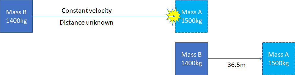

Mass A is stationary, weighing 1500kg and is impacted (horizontally) by Mass B, which weighs 1400kg. The impact is a direct line at the centre of both masses (i.e. for the sake of me keeping up with you experts, please assume no rotational consideration, ignore friction, and assume constant velocity without deceleration or acceleration - which I realise will irritate the purists, but you'll lose me otherwise).
Mass A is displaced 36m after impact in a straight line. Mass B stops at the point of impact with negligible momentum and rotation.
Is there a way for me to calculate the speed/velocity at the time of impact?

You need to know the speed of mass A just after the collision. The distance it traveled is not enough - you need to know the magnitude of the force that brought it to a stop over that distance.

If you knew the coefficient of kinetic friction between mass A and the floor you could find the acceleration after impact (a=-μkg). With the stopping distance s, that would tell you A's velocity just after impact (v2=-2as).
Then knowing the two masses you can use conservation of momentum to find B's velocity before impact.
