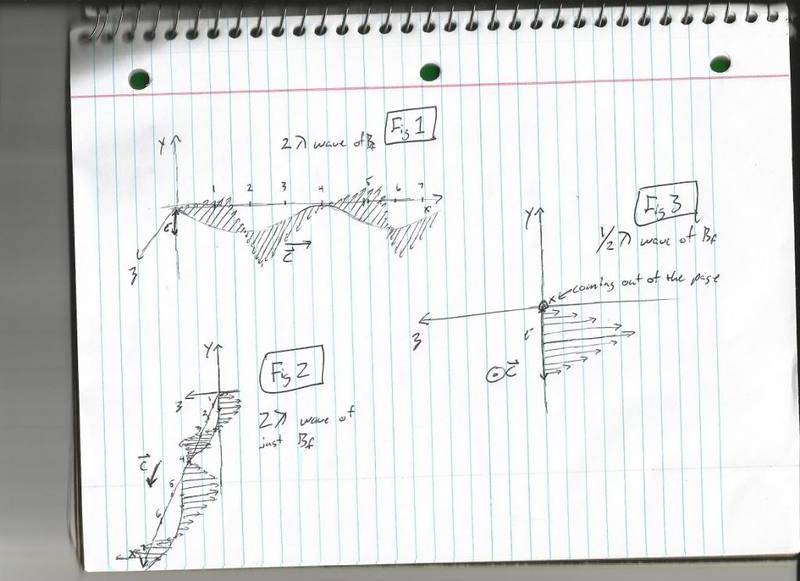

A moving charge creates a Bf so is an EM wave created (for example) by an electron oscillating in a conductor producing a changing Bf which then induces an Ef with both perpendicular to the direction of propagation? If so I am presuming the point where the Bf crosses the axis represents the point where the electron had changed direction, is this correct?

Along x in the image below. So I am assuming the point where the Bf crosses is where the direction of velocity of our oscillating electron (at distance traveled at velocity 'c') is changing so had no velocity and therefore no Bf, is this correct?
So you are saying I should be more specific as it is the acceleration that causes the change in magnitude of the Bf and resulting induced Ef as there could be no 'wave' with constant velocity?

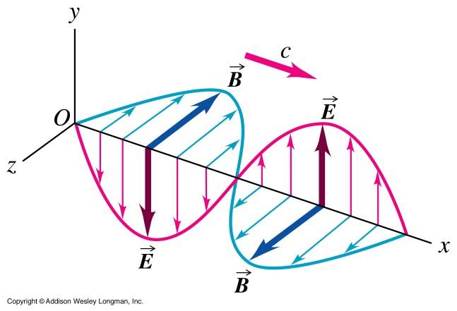

Though I have a question which the diagram helps, so the electron jossels about and you're saying where the acceleration changes is like the origin of the diagram, well I remeber hearing that each electron only emitts one photon, well which way does it propagate? In the x direction or -x direction?

Agreed, in the meantime here is how I see it:
All three figures show the Bf created by a moving electron oscillating in the negative 'y' from the origin with an EM wave moving out along 'x' at 'c'. The magnitude (arbitrary scale of course) at each point is shown by the arrows with the point of maximum velocity being at the center of oscillation. Obviously this doesn't include the induced Ef but that is a basic relationship of cross product of the changing Bf through space so can be omitted since this is understood.
Figures 1 and 2 represent 2λ and fig(3) 1/2λ. So we know there will be a magnetic field creating an EM wave propagating through space but due to the oscillation of the electron the points of highest magnitude/velocity are not typically at their highest magnitude over the majority of any axis which is drawn (although through symmetry it can be drawn the way we typically see EM waves as in the previous image)
As such the magnitude will be stronger outside of that axis at any point except (assuming the 'new' axis is drawn bisecting the oscillation) 1,3,5,7,... will be accurate representations and since points 0,2,4,6... being the points of no velocity of the charge moving back to the oscillation at 'c'
An issue I see with these figures is the magnitude of the Bf dropping off at 1/r^2 from the oscillation.
Any thoughts?

Well then let us start with the simplest idea and break it down from there before getting into Heisenberg. How about an oscillating electron inducing a Bf? ;)
The Figures are a 2 dimensional representation of a plane of the Bf (at some point in time) created by our moving charge. There is no 'probability' to this behavior so makes drawing a representative wave, it's direction, and amplitude straightforward.
The accompanying figures should be an satisfactory 2D representation of that wave propagating outward from the oscillation at 'c' unless you see (or someone else for that matter) something I missed. I understand that the Ef is not drawn but as mentioned earlier since this can be shown as nothing more than a simple representation of cross product it can be omitted as this is understood.
It is interesting that an EM wave drawn along a straight axis is not a true representation for the maximum amplitude of our magnitude of the wave along most points of our axis although since the drift speed of electrons is negligible (and therefore only a small distance is traveled) compared to the propagation speed of our wave at 'c' I suppose to some extent it can be disregarded for now.
What do you think?
I think that your drawing is wrong in the same way that showing a yr 9 student an electron revolving around a nucleus is wrong (orbital theory etc)
Extrapolating on your point that drift velocity is negligable I might submit that perhaps the electron doesn't move at all for like kHz just hovers oscilating inpercievably small distances, and instead of there being some sort of physical acceleration for your zero point, that it is to do with something like molecular spin.
As Feynman said, we don't know that photons actually travel in straight lines.

Bf is induced by current, or in other words any time there is a charge in motion to your F.o.R. You can find out more in any Physics texts that covers electricity and magnetism.
As far as the Ef is concerned it is nothing more than the result of the Bf but perpendicular to it and to that of the direction of motion. I feel like I was able to answer my original question and am happy with the results shown here unless someone on the forum has a reasonable objection.
The only thing I would add is it would be better to view the EM wave from a standpoint far away from the oscillating electron as the waves amplitude decreases by 1/r^2 and therefore would be more similar to a conventional representation (like the first diagram above) when viewed at far distances from this oscillation. Anyway, it's been fun, see you around the forum.
