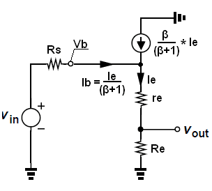

If you want included Rs resistor we modify the diagram
And we can find overall voltage gain of this circuit
Av = Vb/Vin * Vout/Vb = Rin/(Rs + Rin) * Re/(re+Re)
where Rin is a Emitter follower input resistance.
Rin = (β+1)*(re + Re)
