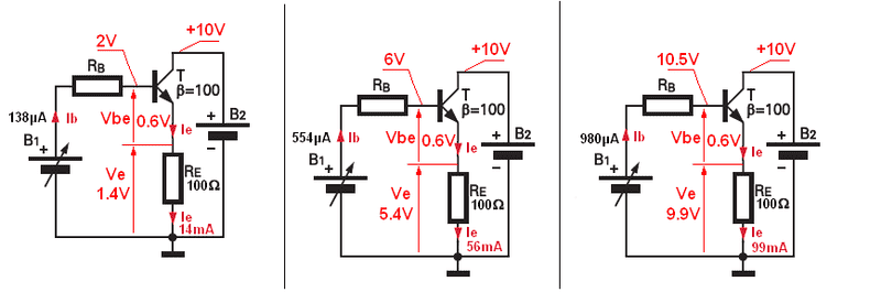

Hi all. So I have been trying to understand how a emitter follower (common collector) works. But I can't seem to grasp the physics behind it. I know it is used as a buffer, it has high input impedance and low output impedance. I don't know what properties cause the output voltage to follow the input voltage. Also if you have "The Art of Electronics," on page 67 where it says "Important points about followers," I can't understand why clipping occurs for the signal. For some reason this whole thing is kind of vague to me. Please help. Thank you.

Emitter follower is a very simply circuit. The output voltage is always 0.6V lower the the input voltage.
See some examples
Also notice that the base current is (β+1) smaller then emitter current (load current).
So our base current source B1 see our load ( Re resistor) not as 100Ω resistor. But B1 see (β+1)*Re load.

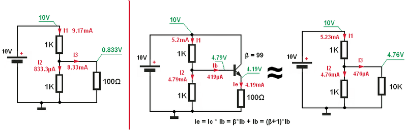

Here you have anther example.
Spouse we have a 1K resistor voltage divider supply from 10V battery.
Without any load connect to the output terminal of our voltage divider the output voltage is equal 5V. Now we connect a 100Ω load resistor across the output terminal.
And now our voltage divider output voltage drops from 5V to 0.83V. So we ruin our circuit.
To fix this issue we add a buffer (emitter follower) see the diagram
Now I hope that you see why we say that emitter follower has a high input impedance and low output impedance. It's all thanks to BJT and his current gain.

For the first image, second figure, the current through Re, should it be 54mA?
I still don't understand page 67 of "The Art of Electronics" under "Important points about followers," number 1. If anyone can help that would be great.
Yes, my mistake.

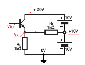

As for the clipping. The clipping can occur when transistor change his state eg. conduction to cut-off. See the example form The Art of Electronics
I slightly change the diagram
And ask yourself one question. What voltage you need to provide to open BJT in this circuit. Also look at figure 2.9 in Art of Electronics.

Cut-off happens at voltages less than .7v?
Is the answer .7V ?

On page 67 of "The Art of Electronics" it says:
The output can swing to within a transistor saturation voltage drop of Vcc, but it cannot go more negative than -5 volts. That is because on the extreme negative swing, the transistor can do no more than turn off, which it does at -4.4 volts input (-5V output).
I don't understand why clipping occurs at -5V (or -4.4V input) when cut-off happens at .7V. In other words shouldn't clipping occur at .7V?

No 0.7V Is a Vbe voltage not the base voltage or load voltage.
In this imagine without BJT the Ve voltage is equal 5V so to open the BJT Vb voltage must be higher then 5.6V. So If input voltage is greater than 5.6V the BJT is active mode and the voltage across the load resistor is Vout = Vin - Vbe. But if Vb is smaller than the 5.6V the BJT is in cut-off stage. And the Ve voltage is constant 5V. Input voltage don't affect the VE voltage any more because BJT is cut-off.

Thank you so much that makes so much sense. Continuing on your example (assuming Ve is 5v when BJT is off), if Vin is 7v then Ve will be 6.3V, is that correct? Also does it saturate at 20V?
perplexabot said:
Thank you so much that makes so much sense. Continuing on your example, if Vin is 7v then Ve will be 6.3V, is that correct? Also does it saturate at 20V?
Yes for Vb= 7V The output voltage Ve ≈ 6.3V
As for the saturation for Vb = 20V bjt is almost enter the saturation region.
To enter saturation Vb must be higher the Vcc.

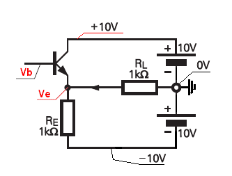

Ok So now if we change the GND position as you have in Art of Electronics
I hope that now you see that without BJT we have VE = -5V. And now if you want to open the BJT the Vb voltage must we greater (lees negative) than -4.4V. If Vb is lower (more negative) than -4.4V the BJT is in cut-off mode.

Truly amazing explanation. I finally understand. Thank you so much.

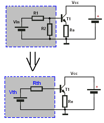

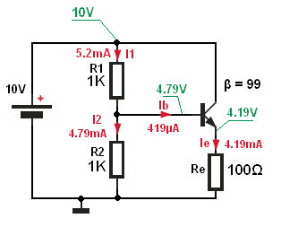

How did you solve for Vb or Ib in the second circuit?
I use a circuit theory and solve the circuit.
From the II Kirchhoff's law we can write
Vcc = I1*R1 + I2*R2 (1)
I1 = Ib + I2 (2)
I2*R2 = Vbe + Ie*Re (3)
And Ib = Ie/(β+1) (4)
And we can solve this for Ib.
[itex]\LARGE {I_b = \frac{R2Vcc - Vbe(R1+R2)}{(\beta +1)Re(R1+R2) + (R1R2)}}= 419.047619\mu A[/itex] I assume β = 99 and Vbe = 0.6V
Knowing Ib we can easy solve for Ie. Ve and Vb
But there is also a simpler way to solve this circuit by using thevenin's theorem.
We can replace the voltage divider (this gray rectangle) with his Thevenin's equivalent circuit
Vth = Vcc * R2/(R1+R2)
Rth = R1||R2 = (R1*R2)/(R1+R2)
And now we can solve for Ib
Vth - Ib*Rth - Vbe - Ie*Re = 0
And we also know that
Ie = Ib*(β +1)
so we end up with
Vth - Ib*Rth - Vbe - Ib*(β +1)*Re = 0
[itex]\LARGE Ib = \frac{Vth-Vbe}{Rth+(\beta +1)*Re}[/itex]
And this is the end.

Most of what you wrote made sense but I do have 3 questions.
I1 = Ib + I2 (2)
How did you get equation (1)? Is Vcc = 10V, if Yes, then I think I get it.
I am familiar with thevenin's theorem, but I don't know how you got Vth = Vcc * R2/(R1+R2)? Once again if Vcc = 10V, then I think I understand.
Vth - Ib*Rth + Vbe + Ie*Re = 0
Isn't this supposed to be: Vth - Ib*Rth - Vbe - Ie*Re = 0 ?
Or are you assuming the emitter current going from ground to transistor?
I am sorry if I am asking for too much. You are helping me a lot.
Vcc is a supply voltage Vcc = 10V in our example.
No I made a typing error. Point for you.
I edit my post and correct the error.
Thank you.

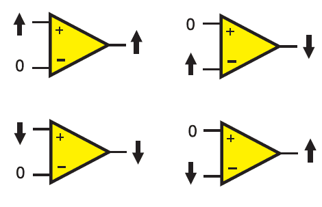

perplexabot said:
Thank you all for your great replies.
Why will a change in Vout cause a change in Ib? Why would Vout change in the first place? Isn't Ib the one that is being "controlled" and so is subject to change?
This is basic approach to feedback theory.
An emitter follower is a circuit with Feedback. That accounts for the way that the output impedance is a lot lower than the value of the emitter load Re. If you want to analyse how feedback works (this is a general principle) you introduce an error signal and see the effect of the circuit on correcting this error. A reason that Vout could change could be that Re changes (or even that the current gain changes a bit). The feedback mechanism (involving the very high current gain of the transistor) corrects this by adjusting the Emitter current and bringing it back to (very near) what it was. When an output voltage is controlled to be more or less independent of the load, this is known as a voltage source or low impedance source. This basic approach may be unfamiliar to you but it is the way that we can see how circuits can be linearised, their frequency response flattened and their input and output impedances controlled.
You can use the methods described elsewhere in this thread to analyse what the circuit will do and they will give answers but you would need to do the sums, piecewise, for a range of values of Re, say. Approaching it as a feedback problem, you get the effective output impedance (etc.) irrespective of the value of Re. The same approach is used, of course, in amplifiers using Op Amps and simplifies many amplifier circuit problems significantly by omitting many of the less relevant circuit values.
Hello again. I have dealt with feedback before in op-amps, however the idea was hard for me to think about. I can understand the fact that feed back "corrects" changes of Vout so that it goes back to what it was but I don't know how this happens. That is why I am happy that you brought this subject up. When I dealt with op-amps, I treated them as black boxes and didn't think about how this can happen. Here is my reasoning of why feedback occurs in a transistor, please tell me if I am right/wrong or am missing something:

And in deep op amp analysis you can find here
https://www.physicsforums.com/showpost.php?p=3866238&postcount=3
I recommend you to read this
Thank you for the reply and the informative link.
In the link you say:
Now suppose the output voltage tried to drift in a positive direction. Can you see that this positive change would be felt through R2 and would cause the inverting pin (-) of the op amp to become slightly positive Since essentially no current flows in or out of the op amp input and the (+) input of the op amp is at ground potential. This causes VD to be greater than 0 with the (-) terminal being the most positive.
Shouldn't VD be LESS than 0? Because VD = V"+" - V"-" where V"+" = 0 and V"-" is positive so VD = 0 - (POSITIVE #) = a negative VD < 0
Well you right VD is negative, but this description corresponds to this drawing
https://www.physicsforums.com/attachment.php?attachmentid=46245&stc=1&d=1334484384
But as you can see both of these methods gives the correct (the same) answer.
Negative VD forces the output voltage to decrease its value.
