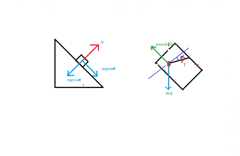

You hang a plumb bob inside an empty box. The empty box slides down a friction-less inclined plane. The inclined plane makes an angle of 30 degrees with the horizontal. What is the angle the plumb bob makes with the vertical during the slide?
g pulled down on the string at 9.81 m/s^2... and the Tension = should be the same in the opposite direction
I know that the box is accelerating down the slide and the string continues to exert an upward force on the plumb bob to balance the gravity acting on it. The plumb bob should hang an angle towards the back of the box. I tried to draw it out but I am not even sure if I have it right so far.
Hi Karina. Welcome to PF.:)
Can you draw the free body diagrams of box and bob?
Do you know have knowledge about pseudo force?
Not sure if this will suffice? Is that correct? We haven't gone over that in class yet but I am aware that it's a fake force, like something we make up. Is that what I was thinking earlier in the explanation, a pseudo force?

Yes pseudo force is a fake force.

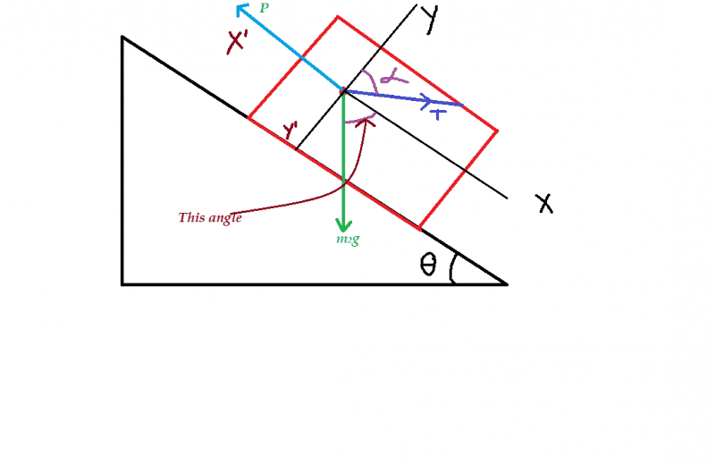

Figure 1 is the FBD of the box and Figure 2 is the FBD of the bob.
Here I am considering a reference frame which is moving with the box. As it is a non-inertial frame of reference so we have to consider a pseudo force. Can you find the magnitude of pseudo force acting on the bob?

In this figure I have drawn the FBD of that bob. Consider force 'P' in the figure as pseudo force.
In figure I have also specified the the axis. Just find the components of forces along the X and Y axis and construct equation using second law.
For that you have to find the value of angle which I have mentioned. Can you find it?

The bob hangs from a rope, so it "feels" the tension of the rope, and the Earth is pulling on it straight down.
That's all the forces it "feels". If it's to accelerate down the slide at the same rate (##\ g\sin\theta\ ##) as the box (i.e. not swing around like puppet on a string), the net vector sum has to be ##mg\sin\theta\;##. In other words, the string has to compensate ( ## mg\;## straight down ) minus ( ##mg\sin\theta\;## downwards along the slope).
Much simpler...
