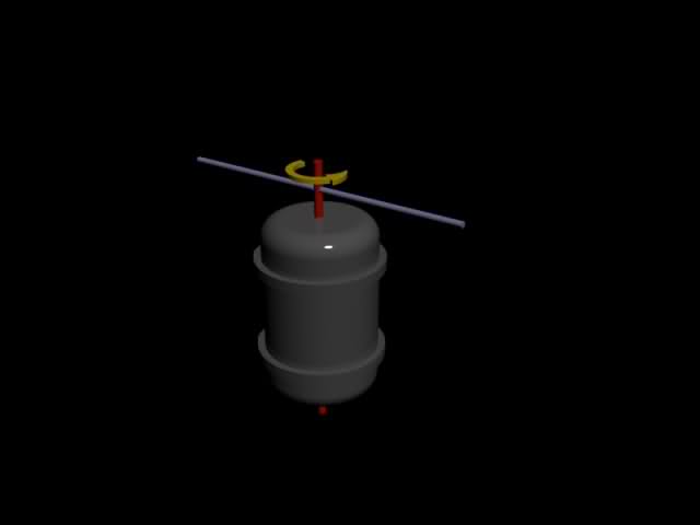

As known, the Earth receives that solar radiation and its value approximately is equal to 1.4 W/m² (data taken from here: http://en.wikipedia.org/wiki/Solar_radiation ). Now imagine that there is some electric motor placed in the Earth’s orbit and it rotates the rod with some certain mass (let’s say 100 000 kg) and at some constant velocity (for example 2 revolutions/sec) :smile:
3D rendering of a gyroscope-like rig: a dark cylindrical body with a rotating rod through its top, a yellow circular arrow showing rotation, and a thin blue-grey bar across the top.
Can we calculate what amount of solar panels (I mean their total area in square meters) will be needed for rotating this rod by means of this electro motor? :smile:

Ultimately the answer is, "Virtually any size solar panel will do the trick." Why? because you only need a finite amount of energy to initiate the rotation, and you did not specify any time period over which the acceleration from static to 2 RPS needed to occur. To calculate the energy required you would use:
E = 1/2 * m * (wL)^2
I will leave solving that to you, the question was about the size of the solar panel, so let's assume you decide on a 1.5V 100mA panel and motor. Let's further assume that the total energy required to reach 2 RPS is 10kJ (I just picked a number), we would then be able to calculate how long it would take to achieve the final speed,
10,000J = 1.5 * 0.1A * T ==> 66,666 seconds (18.52 Hours).
This obviously assumes 100% efficiency in the conversion of the electricity to mechanical energy. But what I am more curious about is how you intend to get a 100,000kg mass into orbit!
Anyway, in theory, you could use a 1V source with only 1uA of current and still reach the same speed, it would just take a lot longer.

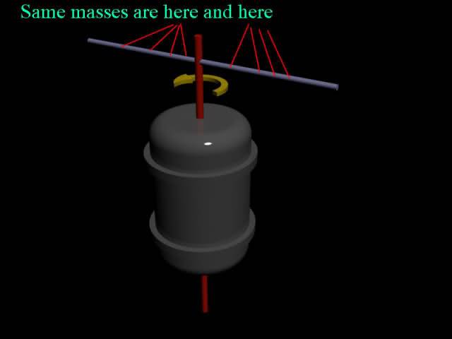

Do I need to do it? Your formula E = 1/2 * m * (wL)^2 is enough for my situation, right? I will specify one thing: the rod is balanced, that is there are the same masses at rod’s both sides (let’s say 50 000 kg and 50 000 kg to each sides):
Diagram of a balanced rod pivoting on a vertical red shaft, with a curved yellow rotation arrow and a cylindrical gray mass at its base; red leader lines point to masses on both sides of the rod, labelled Same masses are here and here.
So, that formula (in red color) is suitable, right? :smile:
Wouldn't the motor also rotate, but in the opposite direction?
If this was to be minimized, then the motor would have to be a lot heavier than the rod or attached to something that was.
Of course, rod’s rotation generally forces the motor to rotate to opposite direction, but this undesired rotation can be canceled by means of second rod rotating at opposite direction, so it is not problem :smile:
