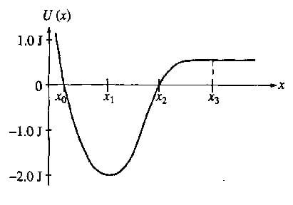

And here's the odd ball question.
15. A conservative force has the potential energy function U(x), shown by the graph
above. A particle moving in one dimension under the influence of this force has kinetic energy
1.0 joule when it is at position x1 Which of the following is a correct statement about the motion of the particle?
(A) It oscillates with maximum position x2 and minimum position x0.
(B) It moves to the right of x3 and does not return.
(C) It moves to the left of x0 and does not return.
(D) It comes to rest at either x0 or x2.
(E) It cannot reach either x0 or x2.
This one I know the answer to, but have no idea how to get there. The answer is E. Why? Can someone please explain?
I thought I'm supposed to add up U and K to find E, so I added 2 + 1 = 3 J. This obviously is wrong. What's the correct approach to this problem?
