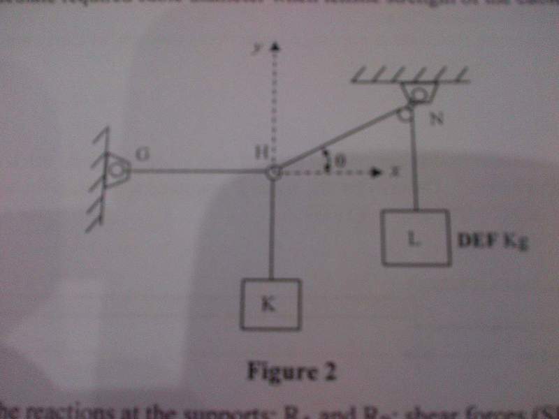

An assembly shown in the picture, GH , HK, HNL are three cables. the mass of box L IS 64Kg,
a) determine the mass of box K in order to make angle theta as 25 degrees
b) determine the reaction forces at supports G and N
c) calculate required cable diameter when tensile strength of the cable is 20MPaI can't seem to do these questions and its stressing me out because i could do it before but I've totally forgotten how to now. any help would be more than great!

First identify which principles will be involved. In this case, static equilibrium. What do you know about equilibrium that might apply in this case? What other principles might be involved?
