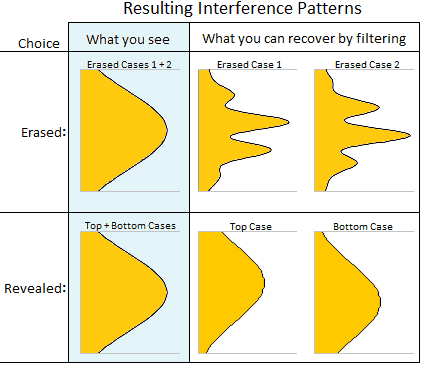

Here's a discussion of how interference can be created and destroyed. I haven't completely absorbed to the extent of being able to answer your questions adequately:
https://en.wikipedia.org/wiki/Quantum_eraser_experiment
But note the comment:
Bob can only distinguish the two peaks in his data after he got access to Alice's results
Alice might view her actions as affecting Bob's interference pattern (or destroying his interference pattern), but Bob can't actually see this effect without knowing what Alice knows.

The explanation is that entangled photons do not produce an interference pattern as you might expect. The easiest way to understand this is that they are not coherent.
Regardless of what Alice does on her end, Bob sees a bland lack-of-interference pattern.
The only way to find an interference pattern is for Alice to measure her copy in a particular way, have her tell Bob the result, then have Bob combine the results together to find that Alice's results split Bob's results into two complementary interference patterns.
An equivalent way to think about this is that Alice isn't controlling Bob's outcome, she's getting a noisy prediction of what it was or will be. When Bob's photon hits a point associated with a peak in 'Erased Case 1' and a trough in 'Erased Case 2', Alice is much more likely to measure the result corresponding to 'Erased Case 1'.

The fact that the answer has a positive vote count is more significant than the fact that it has views. I have no idea why it has a positive upvote count.
The problem with the paper is really obvious: the author thinks that the quantum eraser leaves the system in the state ##|+\rangle + |-\rangle## with certainty, when actually it leaves the system in the state ##|+\rangle + |-\rangle## 50% of the time and the state ##|+\rangle - |-\rangle## 50% of the time. So the author thinks they have a pure state ##|+\rangle + |-\rangle## in one case and a maximally mixed state 50% ##|+\rangle## + 50% ##|-\rangle## in the other case (though they don't seem familiar with that terminology). But actually it's a maximally mixed state in both cases.
The rest of the paper is about distinguishing a pure state from the maximally mixed state. Which is trivial, and doesn't need to be explained in a paper.
That's why the paper is on vixra (it couldn't even make it to arxiv): it's junk with trivial flaws.
