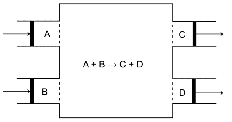

The Van't Hoff equilibrium box is a device for carrying out a chemical reaction between ideal gas species reversibly. That is, it carries out a process in an open system for converting pure reactants to pure products at quasi static (negligible) rate of reaction.
The Van't Hoff equilibrium box is a chamber containing a mixture of reactants and products at equilibrium. It is connected to an array of cylinders, each containing one of the pure reactants or products. The chamber itself is operated at constant total pressure and temperature. The cylinders are each connected to the equilibrium box through a semipermeable membrane that only passes that species into the chamber. Pure species are introduced in stoichiometric proportions to the chamber through these membranes at pressures that are the same as their partial pressures in the reaction mixture, and pure products are removed in stoichiometric proportions at pressures. that are the same as their partial pressures in the reaction mixture. So the operation of the equilibrium box is reversible, and the delta G in going from pure reactants into pure products out is zero.
For more details, see Introduction to Chemical Engineering Thermodynamics by Smith and Van Ness, Chapter 15, pages 505-507.

As I said in the post's you quote, bringing about the change from the initial standard state of pure reactants at 1 bar and 298 K to pure products at 1 bar and 298 K involves a 3-step process:
1. Expanding the reactants isothermally from 1 bar to their partial pressures in the equilibrium box
2. Continuously (quasi statically) injecting reactants through semi-permeable membranes into the equilibrium box at their equilibrium partial pressures, allowing them to react to form products, and continuously (quasi statically) removing products through semi-permeable membranes at their equilibrium partial pressures.
3. Compressing the products isothermally from their partial pressures in the equilibrium box to 1 bar
So, $$\Delta H^0=\Delta H_1+\Delta H_2+\Delta H_3$$$$\Delta S^0=\Delta S_1+\Delta S_2+\Delta S_3$$$$\Delta G^0=\Delta G_1+\Delta G_2+\Delta G_3$$But, for ideal gases, ##\Delta H_1=\Delta H_3=0##, so $$\Delta H_2=\Delta H^0$$And, in the equilibrium box, since ##\Delta G_2=0##, $$\Delta S_2=\frac{\Delta H_2}{T}==\frac{\Delta H^0}{T}$$For a reaction of ideal gas species, such as ##aA+bB=cC+dD## for example, the entropy changes for steps 1 and 3 are: $$\Delta S_1=-aR\ln{p_A}-bR\ln{p_B}$$and$$\Delta S_3=cR\ln{p_C}+dR\ln{p_D}$$So, for the standard entropy change for this reaction, we have:
$$\Delta S^0=-aR\ln{p_A}-bR\ln{p_B}+\frac{\Delta H^0}{T}+cR\ln{p_C}+dR\ln{p_D}=\frac{\Delta H^0}{T}+R\ln{K}$$where K is the equilibrium constant. So, $$\Delta H^0=T\Delta S^0-RT\ln{K}$$

Here is a quote from your post in which working principle of Van't Hoff equilibrium box is explained: "The Van't Hoff equilibrium box is a chamber containing a mixture of reactants and products at equilibrium." How is it possible that there are no mixing effects in the chamber since you said that in Van't Hoff equilibrium box there is a chamber in which there is reaction mixture at equilibrium? Reaction mixture in itself has a key word MIXTURE, which means components of chemical reaction are mixed. Without mixing, Gibbs energy couldn't reach minimum with respect to reaction extent (Specific U shaped curve of G couldn't happen without mixing). For, how can system be at chemical equilibrium without mixing?
How does the entropy per mole of a pure ideal gas species at pressure p compare with the partial molar entropy of the same gas species at partial pressure p in an ideal gas mixture?

But I'm not talking about about going directly from 1 bar to the partial pressures in the mixture. We've already accounted for that entropy change in the expansion or compression steps.
The partial molar entropy of a species in an ideal gas mixture is the same as that of the pure species at the same pressure as its partial pressure in the mixture. So the entropy change in injecting a small parcel of pure ideal gas through a semipermeable membrane into a mixture of ideal gases containing that species at the same partial pressure as the total pressure of the pure gas is zero. That follows directly from Gibbs Theorem: the partial molar U, H, S, A, and G of a species in an ideal gas mixture is the same as that of the pure component at the same pressure as its partial pressure in the mixture.

Yes, I agree. Only how could components diffuse through membrane without pressure difference?
It's like any other reversible process. There is a slight pressure difference imposed across the membrane.
