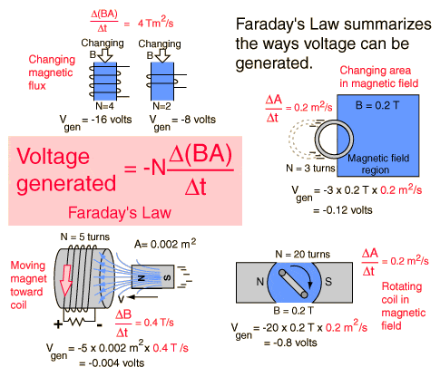

Welcome to Physics Forums. What you need is to understand Faraday's Law.
So to generate 240 volts from a solenoid with 4 coils that passes over an unknown magnetic field at 29m/s it would take a magnetic field with a density of 2.0689 T?
Represented by 240v= (4)(x)(29) where x is the density of the magnetic field?
Ik it sounds like a homework question but its not just a personal project question lol
Note that you are referring to the upper right example where ΔA/Δt is the rate of change of the area of the loops with respect to time.
...the second example shows the voltage generated when a coil is moved into a magnetic field. This is sometimes called "motional emf", and is proportional to the speed with which the coil is moved into the magnetic field. That speed can be expressed in terms of the rate of change of the area which is in the magnetic field.
