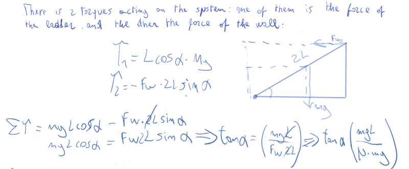

Drawing a diagram for the forces is the easy part. I am not sure I am doing the equation of the sum of the torques well.
This is my attempt for the forces[/B]
And this for the torques:

If you calculate torques about the point of contact with the ground, there are 3 torques to consider not just 2. You missed the torque generated by ##F_{f2}## at the point of contact with the wall.
