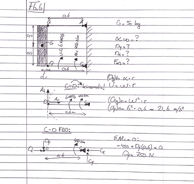

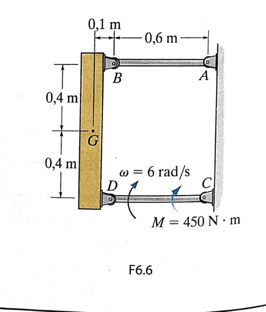

The angular velocity of rod CD is at the moment shown in the figure 6 rad/s. A moment is applied at rod CD of M = 450 Nm. Determine the force in rod AB, the horizontal and vertical force at pin D and the angular acceleration in rod CD given at the moment shown in the figure. The block has a mass of 50 kg and his center of mass is at point G. Neglect the masses of the rods.
(ag)n = w^2 * r
(ag)t = alpha * r

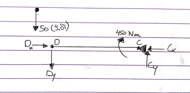

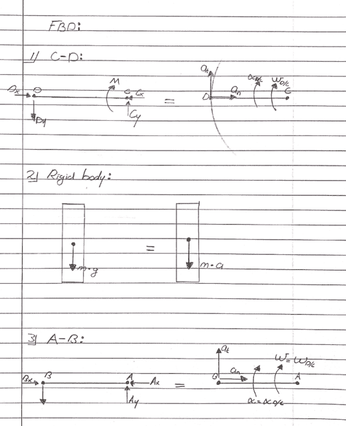

Hello,
Given the statement a described above. To find the forces at point D I drawn a kinematic scheme and FBD of rod CD. But why am I allowed to ignore the mass of 50 kg, the forces at point B and point A? I know the are some rules about this, but I just can't remember them anymore.. The figure of the situation can be found below.
See my sketch with calculations:
Why ignoring the mass of 50 Kg?

Links AB and CD do not have a mass value; their only function is to force point G, which represents a mass of 50 kg, to describe a semicircular movement that is pretty close to the trajectories of points B and D.
Link CD is under the effect of a torque or moment about pivot C, which induces the acceleration of those 50 Kg.
The centripetal component of that acceleration, combined with that mass, induces centripetal forces that are equally shared by links AB and CD of similar leghts (both points, B and D have same radius of rotation).

The moment becomes a force at point D.
The mass, combined with gravity accelerataion, becomes another force.
Is this what you mean?

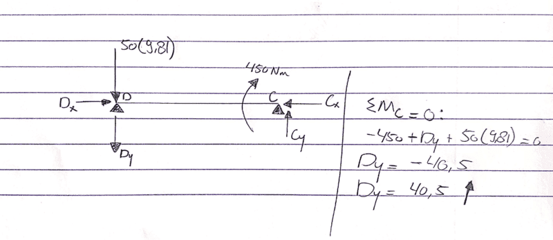

Are those the FBD's for this structure?
We have two vertical forces acting on D: M/0.6(upwards) and 50g (downwards).
Therefore, there is a resultant force pushing and accelerating G up at the instant represented in the diagram.
That makes the following (below) FBD?
Make that last FBD sense to you @Lnewqban ?
Like to hear :)
