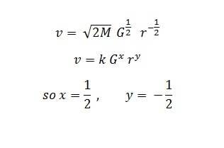

are you sure that g in that equation is g the acceleration . not G the gravitational constant
i think its G
becouse the escape velocity Ve=(2GM/r)0.5
and you can rearange that to get :
i guess its not that simple

Hello, patric44. It appears from the statement of the problem that g represents the acceleration due to gravity (apparently at the surface of the earth).
When helping someone with a question, please don't provide a complete solution. This is against the rules of the forum. Try to provide just enough assistance to get the questioner on track. Thanks.
i don't think that a truly complete solution i mean its only one equation.
i only wanted to show him if it was G it will be much simpler ... sorry any way :)
