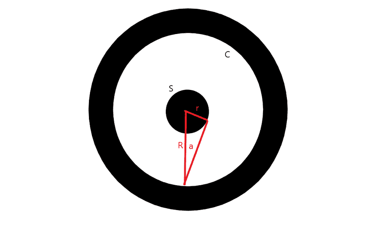

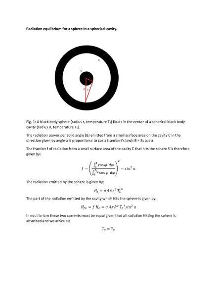

I dismissed the idea of a sphere in a spherical cavity too quickly (in post 13).
If we add the (idealized) fiber fiber optics I describe in post 19 I'll reconsider.
Alternatively one could work out how much of the radiation from the inner wall of the cavity hits the sphere in the middle and how much goes to some other place on the cavity wall. Bit of geometry.
I don't completely understand your post:
Does the spherical shell give off heat to the outside too?
Are you discussing a steady state situation with two different temperatures or static equilibrium?

An object in any cavity within a black body with a uniform (necessarilly steady I suppose) Temperature will equilibrate to that Temperature. The black body can be radiating externally or not so long as the temperature is steady and uniform.
Does that help?

I've tried the following now.
It's all in a Word-file, but I'll summarize here.
Fig. 1: A black body sphere (radius r, temperature TS) floats in the center of a spherical black body cavity (radius R, temperature TC).
The fraction f of radiation from the cavity C that hits the sphere S is given by the ratio of the solid angle corresponding to the angle a shown in figure 1 and that corresponding to π/2: f = 1- cos a
I'll leave it to whoever is interested to check my results, but I can send my own derivations on request.
I'm not taking diffraction into account. The sphere could be huge compared to most of the wave lengths involved.

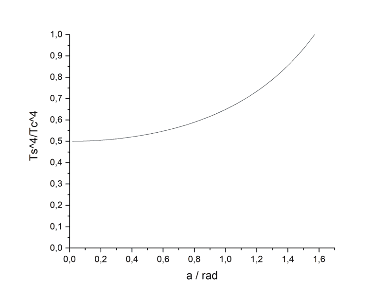

Now the central assumption where the problem might hide:
In equilibrium the radiation emitted by the sphere must be equal to the fraction of the radiation emitted by the cavity which reaches the sphere.
This leads to a ratio (plotted in figure 2)
TS4/TC4 = (1 - cos a)/sin2a
Fig. 2: Ratio between the fourth power of the sphere’s and the cavity’s temperature as a function of the cone’s half angle a.
Assuming I didn't make a mistake in the maths, am I maybe misusing the radiation formula H = A e σ T4?
