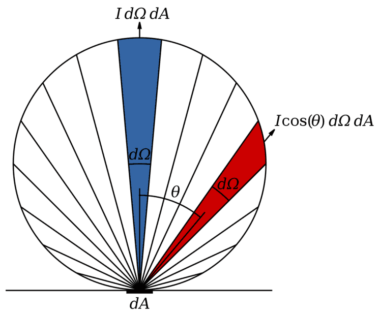

A quick update on whether or not radiation from a black body is isotropic.
I've read a bit about Lambert's law in an old book (Optical Physics by Max Garbuny) and he mentions that a glowing sphere looks like a flat disk, which means that radiation from the surface of a black body is actually isotropic.
If radiation was more intense in the direction orthogonal to the surface the sphere would look like a disk that fades out towards its edge.
The brightness (or radiance), however, is proportional to the cosine of the angle (measured from the direction orthogonal to the surface). (This is Lambert's law.)
This is simply because brightness is given as power per solid angle and per emitting area.

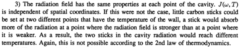

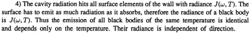

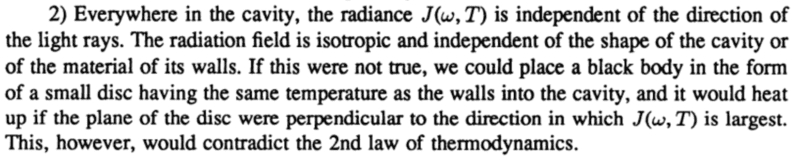

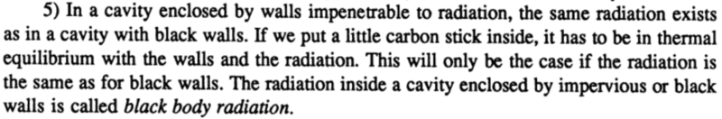

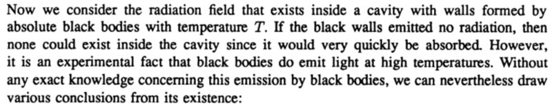

Here is how Walter Greiner presents it in Quantum Mechanics: An Introduction:
Printed textbook paragraph about the radiation field inside a cavity with absolute black body walls at temperature T, noting that black bodies emit light at high temperatures.
Printed text, numbered item 1: after a short time the radiation inside a cavity reaches thermal equilibrium through emission and absorption by the walls, and once reached the radiation field no longer varies.
Printed text paragraph numbered 2 stating that the radiance J(ω, T) inside a cavity is independent of light-ray direction, so the radiation field is isotropic and independent of cavity shape or wall material, citing the second law of thermodynamics.
Printed text paragraph, point 3 of an argument on cavity radiation: the radiation field J(ω,T) is independent of position, otherwise carbon sticks at two points at wall temperature would reach different temperatures, violating the 2nd law of thermodynamics.
Printed text from a textbook, numbered point 4, stating that cavity radiation strikes all wall surface elements with radiance J(ω, T) and that a black body's radiance is J(ω, T), so emission depends only on temperature and is independent of direction.
Printed text, numbered point 5, stating that radiation inside a cavity with walls impenetrable to radiation matches that inside a black-walled cavity, and that the radiation there is called black body radiation.

In the restframe of the black-body radiation it's homogeneous and isotropic. If it were not, there'd be heat flow from some parts of the container walls to others through radiation until thermal equilibrium is reached.
Lambert's cosine Law follows from this. It's however not about the distribution of black-body radiation within the cavity, which is homogeneous and isotropic in its rest frame, but about the radiation of a black body to the outside. It describes the energy flow of radiation from a surface, and the cosine is that of the angle between the emitter's surface normal and the direction of observation. The Wikipedia is pretty good, as far as I can see:

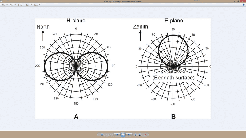

Radiation from an electric dipole, for example, is not lambertian.
I would say things that happen in nature are in agreement with the 2nd law, but that doesn't mean they are caused by the 2nd law.

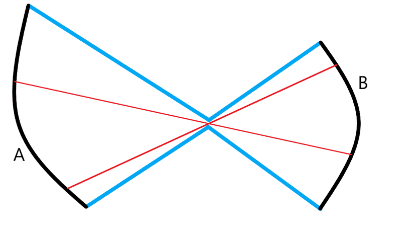

Philip Koeck said:
By some ingenious optical device all the radiation from body 1 is focused onto body 2 and vice versa.

A cos pattern in the vertical plane is what you get from a horizontal transmitting dipole, λ/r4 above the ground. Thinking in terms of EM theory, it seems to me that currents flowing randomly across the surface of a radiator (in all directions) could produce a radiation distribution which follows Lambert's Law. The maxes and nulls in the horizontal plane would average out to half.
Is that crazy, do you think?
Two polar radiation pattern plots: A, an H-plane figure-eight lobe pattern with North marked at top; B, an E-plane pattern showing a lobe toward the zenith, with 'Beneath surface' labelled below the centre.
Is that crazy, do you think?View attachment 332745
Just to clarify. Is the model that there are currents and maybe dipole oscillation mainly in the plane of the surface, but otherwise in random orientations?
This would mean that each "donut" of radiation has a maximum in the direction normal to the plain.
Now these donuts actually have a sin2-profile, but due to the random in-plane orientations this could average out to a cos-profile.
Could work!
I'm not quite sure how you would get zero for a direction parallel to the surface, though.
What does the sin2-donut give when you rotationally average it?
Just to explain why I'm discussing this: It would be interesting that the cos-behaviour of black-body radiation follows from some other physics and then actually agrees with the second law.
That would be like other physics "adapting" to the 2nd law, in a way.
Maybe you could explain this once more. What is the vertical plane and what do you mean by λ/r4 above the ground?
Sorry; a typo. I meant λ/4. Different heights will produce different vertical patterns and my choice of λ/4 was a bit arbitrary but the radiation in the horizontal direction will always be equal if the induced ground image is assumes to be perfect. This link shows patterns of dipoles at different heights. The common feature is a zero elevation. A random selection of independent dipole (uncorrelated signals) will (?) have a max 90 degrees and a null at 0 degrees.
The 'vertical plane' would be the vertical plane through the maximum in the horizontal direction. A large number of dipoles, radiating uncorrelated signals in random azimuths will average out as omnidirectional.
The snag here is that a vertical dipole / monopole will have a maximum at zero elevation. I don't know about the orientation of molecular dipoles on the surface of a solid. Maybe horizontal is a fanciful choice.
