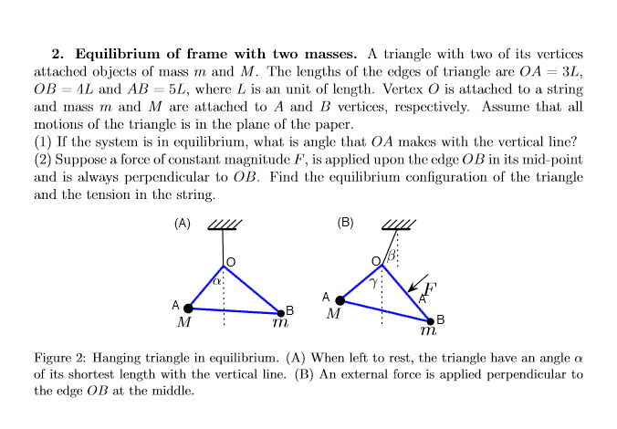

I need to find the tension T, γ and β in part 2 of this question.
The question is attached.
First of all, the frame is a right angle triangle because (3L)^2 + (4L)^2 = (5L)^2
take torque about the point O
we got 2LF + mg(4Lcosγ) = Mg(3Lsinγ)
from the balance of force, we got
Tcosβ=(m+M)g + F cos γ
Tsinβ = Fsinγ
I have listed these 3 equations but I don't know how to solve them
Please give me some help

Hi VHAHAHA! :smile:
Hint: if there were only three forces, they would all have to go through the same point. :wink:

But i think that there are 4 forces
Do u mean that i have to combine 2 gravitational force into 1 combined force so that there is 3 force?

Yup! :biggrin:
The two gravitaitonal forces are known, and they're easy to add …
so go for it! :wink:
the combined g force = (m+M)g
how do go to the same point? i can't see any common point
Just use the resultant. :smile:
(It goes through the point where you'd have to put the fulcrum if you wanted to balance it)

Suppose only two forces go through a point …
then, if you take moments about that point, the moments of those two forces will be zero, and the moment of the third force won't! :wink:

If we see part 1
T=(M+m)g
but these 3 force don't have the common point
they are parallel

ah, they have a common point "at infinity" :wink:
alternatively, my argument only applied when …
… and in part 1, two forces don't go through a point (except "at infinity")! :smile:

There are 4 forces! How to use this rule in part 2 =
