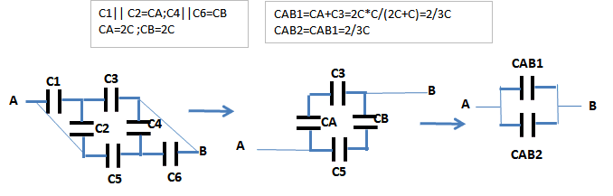

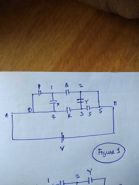

The picture attached with this post shows a combination of capacitors, we are asked to find out the equivalent capacitance between the points A and B.
Provided that all the capacitors are identical and has an individual capacitance C.
Can anyone help me provide basic ideas of solving these kind of problems( I mean a general approach). [emoji4]

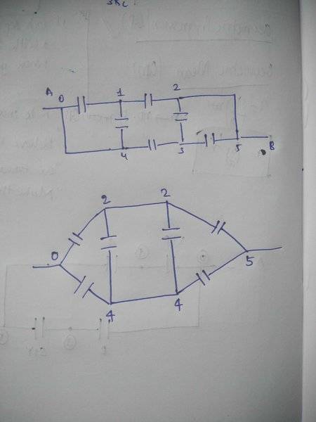

A general approach would be to use the kirkoff circuit laws.
If you don't know about those, you had best look for ways to redraw the diagram so it looks simpler.
For instance ... see that box of capacitors in the middle... number the nodes around them 1 through 4, clockwise, from the top left. Label the node closest to A as 0, and the one closest to B as 5.
Notice that node 4 is the same as node 0.
So those first two capacitors are in parallel.
Redraw it like that ... you'll end up with sort-of nested parallel capacitors. You know a rule for parallel capacitors.
The point of these exercizes is to get you to spot these sorts of patterns.

In that case, I am getting the answer as (2/3) *C
Is that correct..?
jishnu said:
Is that correct
No.
cnh1995 said:
No.
Then could you please help me solve this...
Show us your redrawn diagram as @Simon Bridge recommended - that could be your problem.

Put a voltage source between a and b and analyse the diagram. Can you find any series/parallel connection?

Not exactly. I couldn't figure out one from the diagram the problematic capacitors for me are X and Y(figure 1), but I have doubt whether is it possible to redraw the circuit as to the one I have done in figure 2 then I can find 3 parallel and 1 series circuit of capacitors from that. Am I right in redrawing that circuit? Please explain..

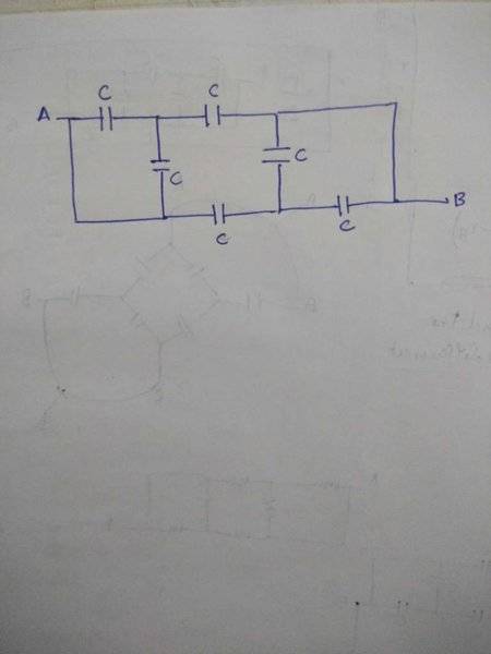

Sorry, this is the figure 2 that I have mentioned in my previous post
Fig 2 is not correct. Q and R are not in parallel in the original. You are trying to make too many simplifications in one go. I would start by just combining Y and S (or P and X) and redraw that.
No.
Note... from diagram 1, nodes 2 and 5 are the same.
So Y and S are parallel... you can collapse them to one capacitor between nodes 5 and 3, node 2 vanishes.
Redraw.
Q connects between 1 and 5 while R connects between 4 and 3... so Q and R are NOT parallel.
Take more care.

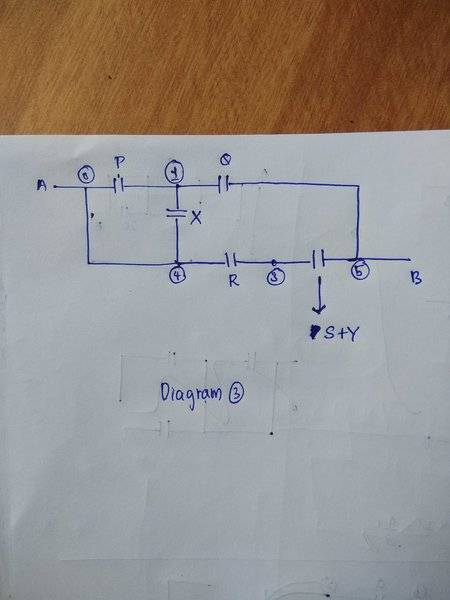

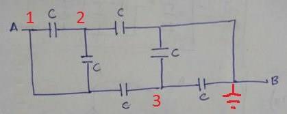

Sir, I am having one doubt, if the node 2 collapses then what happens to the connection between node 2 and node 3..?
I want to know whether the newly attached diagram (diagram 3) can be considered correct after collapsing. Can I proceed the same way for the capacitors P and X ?
Last diagram looks good.
The connection between 2 and 3 becomes a connection between 5 and 3.
The key is that wires are part of the node they are attached to. So two nodes joined by a wire are, in fact, the same node.
This let's you simplify the diagram... you are allowed to draw curved lines for wires/connections.
Now see if there are other capacitor pairs you can collapse this way.

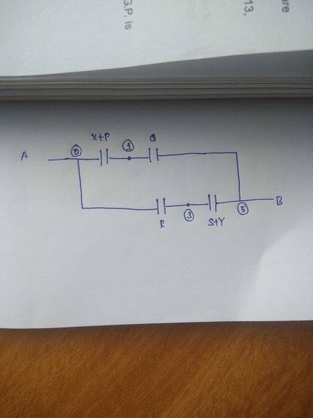

I think in that way we can collapse node 4 and combine P and X with parallel connected capacitors formula to achieve even simpler circuit diagram.

Using this conversion I have redrawn my diagram can you please tell me whether its correct or not?
I also want to know can we use resistor combination formulas and wheatstone's bridge concept to deal with reactance(I mean in simplifying and solving them)...!

That looks fine. Now notice that the two parallel capacitors are placed symmetrically across the two paths 0,2,5 and 0,4,5. The PD across them is zero (when all values are equal) because there is no current flowing across, so you now have two pairs of series C in parallel. No sums actually required now!
PS Resistor formulae also apply to Reactances and Impedances (with care of course - big C = small reactance)

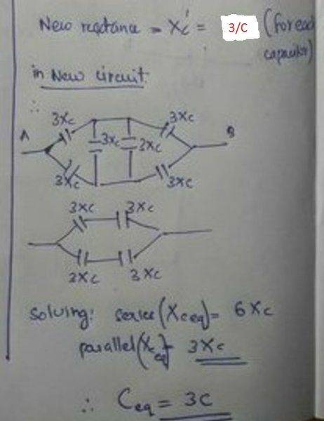

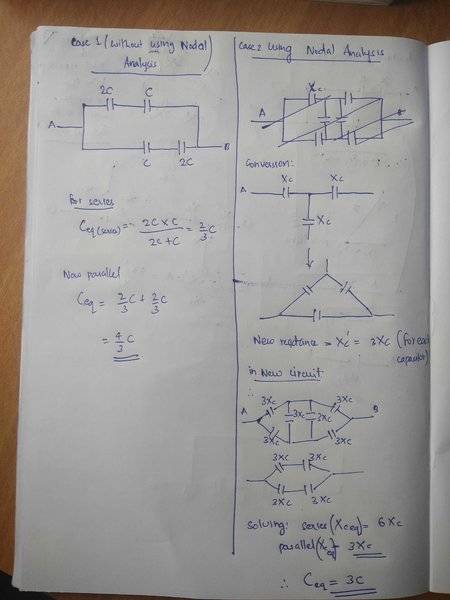

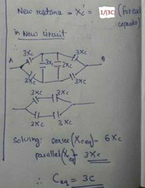

I have tried to solve this question in the both ways suggested
1. Collapsing the nodes
2. Using nodal analysis and conversion
But, still I got some problem. Those two ways are giving me different answers to the same problem. Here I am attaching my answers with this post, can anyone please help me to figure out where I went wrong...!
Here I changed the capacitance as
P = Q = R = S = X = Y = "C" (each has same capacitance)
Recheck your working -- especially where you are rearranging the capacitors in method 2. You seem to have a blindness there.
I am getting the same answers by the two methods.
The point of this sort of exercise is to get you to understand how circuits work ... not to find the answer by correctly applying the rules and formulas. The actual answer is irrelevant to the task in front of you.

I am a bit confused sir, in case of the second method I used the mesh analysis(considering the reactance of the capacitor) to convert the available two stars into delta then as suggested I removed the capacitors connecting 0-2-5 and 0-4-5 (ref post 18) since the PD between them is zero,
There I am stuck with the problem that whether I have to continue solving with reactance(using resistor equations) or by using the new capacitance( using capacitor combination formulas) please help...

So, where did I went wrong in the second method..? Please help
Make the change I show in red and propagate that change through the rest of your calculations:
In post #19, you say that you're going to do a nodal analysis, but then you give up on that and do a wye-delta conversion.
Do you intend to carry out a nodal analysis?
Sorry my mistake, can you please help me know about the difference in nodal analysis and star to delta or vise-versa conversions. Isn't the thing that I have done in #19 also called mesh / nodal analysis(I am not sure about that).
I cannot easily follow everything that you are doing, but for why you are getting a different and wrong answer, it seems to me that you in your second method, maybenot only you, have identified as 'star' something that is not a star. That the 'T' 0124 of #17a is not a star In the textbook sense because 0 and 4 are directly connected with no potential difference between them.
