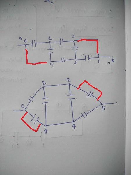

  • #31
jishnu said:
Sorry my mistake, can you please help me know about the difference in nodal analysis and star to delta or vise-versa conversions. Isn't the thing that I have done in #19 also called mesh / nodal analysis(I am not sure about that).
The second thing you did in #19 is called star-delta conversion.
You did not do this: https://www.electronics-tutorials.ws/dccircuits/dcp_6.html, which is called nodal analysis.
  • #32
OK. Forget what I said in #27. After you did the Y-Δ transformation: https://en.wikipedia.org/wiki/Y-Δ_transform
each capacitor has a value of C/3. But, you didn't get the schematic after the transformation correct. Two of the capacitors are shorted by a wire that was in the pre-transformation topology as shown here. Look carefully and you'll see that there are 4 capacitors of value C/3 in parallel for a final value of (4C)/3

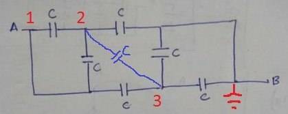

Since you have got the correct answer by two methods, I'll show you what I would consider the most general method, which others suggested early on in the thread.
You can do a nodal analysis like this. First select a reference node and number the rest of the nodes like this:
Take the admittance of each capacitor to be just C. Now you can write the admittance matrix Y by inspection using this method:
After you get the admittance matrix, invert it, giving the impedance matrix Z:
The reactance, and hence the inverse of the equivalent capacitance, of each node is equal the value on the main diagonal of the Z matrix.
The value in red, 3/(4 C), is the reactance from node 1 to ground so the equivalent capacitance is (4 C)/3. Similarly, the equivalent capacitance from node 2 to ground is (3 C)/2, and from node 3 to ground it's (12 C)/5. You get all the equivalent capacitances with one matrix calculation. :smile:

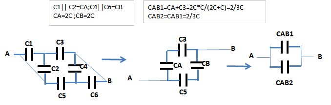

In my opinion, this could be this way:
Does not it?
  • #35
It could be this way:

This is what jishnu did in post #16 and in the left side of the image of post #19
Thanks allot for the clarification. [emoji4]

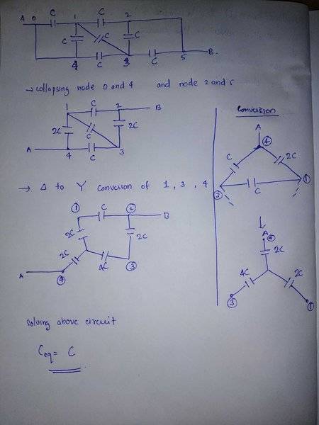

This is how I got the answer(attached a rough work)
Can you please provide me resources to know more about formation of the admittance matrix, I couldn't understand much relevant things about its matrix formation from the electronics tutorial link that you have provided.

When using the Y-Δ transformation: https://en.wikipedia.org/wiki/Y-Δ_transform
the elements of the circuit must be treated as resistances (impedances in our case), not conductances (admittances in our case). We have taken the capacitances to be admittances because of the way capacitors combine when they are in parallel, and when in series. When capacitors are in parallel, their values are simply added. This is not the way resistors (or inductors) in parallel combine.
So for the purpose of this exercise, we treat the admittance of a capacitor whose value is 2C as if it were an admittance of value 2C, or an impedance of value 1/(2C). If we want the equivalent capacitance of two capacitors 2C and 3C in parallel, it's just 5C. But, if they're in series, we must calculate 1/Ceqv = 1/(2C) + 1/(3C), which gives Ceqv = (6C)/5
For capacitors in series, add their impedances; for capacitors in parallel, add their admittances.
When using the Y-Δ transformation be sure to have the values used in the calculation in impedance form, not admittance form.
Here are the steps for the solution of the new circuit I gave you using the Y-Δ transformation. In these images the values shown are in admittance form. Even though it's not shown, to use the transformation I took the reciprocals to convert them to impedances before doing the calculations. The results were then converted back to admittance form by taking reciprocals.
Notice how nicely the nodal analysis method with the nodal equations in matrix form took care of all the reductions and algebra automatically.
