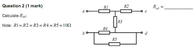

This should be quite simple for most of you although I can't understand it.
Circuit is attached below
The answer is 20ohms, although I would have done R1+R3 + R4//R5 which would get 25ohms.
The previous question was to find Rab and Rab = 25ohms.
How do i view the circuit to get 20ohms? I'm aware it would just be R1+R3, but why can't you do it my way?
Do you agree with the way I have redrawn the circuit?

Yeah that makes sense. I just have trouble redrawing circuits. I need to work on that. Do you have any pointers or suggestions on how I need to approach it?
Should I just imagine a current starting from A and redrawing it according to where the current branches off etc?
My approach to redraw a circuit is to simply reduce the lengthy wires (because they have zero resistance) and bring resistors together as close as possible. Now it should be more clear to see whether the resistors are in parallel or series.
As Zryn has redrawn the circuit, it will quickly indicate you that R4 and R5 are parallel. Find equivalent resistance of R4 and R5 and add it with R1 and R3.
Keep in mind that circuits that test your knowledge of how resistors can be combined will be drawn in such a fashion as to confuse you.
If you have some time, you can practice redrawing them by getting several different color pencil/pen/highlighter/crayon/whatever and color over each different node in a different color, then redraw the circuit in a linear fashion from top to bottom or left to right so that all the resistors point the same direction, and double check that each resistor is connected to the right color nodes.

In this circuit, the path of current goes from "a" through R1 and R3, to "d".
R2 goes nowhere, so you can ignore it.
Although R4 and R5 are certainly in parallel, they are not in the path of the current from "a" to "d".
They are shorted out by the wire going from R3 to "d".
So you can ignore them too.
Yeah, it's just hard for me to see in the picture unless it's redrawn like Zryn did. That's just for me though.
[PLAIN]http://dl.dropbox.com/u/4222062/series%20R2.PNG
Maybe this will make it clearer why R2, R4 and R5 are not involved. You could remove all of them without having any effect on the current in the meter marked "A" in the diagram.
Current only flows in the parts marked in red.
