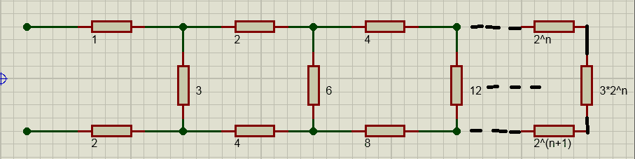

Hi. Anyone knows how to calculate the Req of this circuit? n tends to infinite.
Is this question for schoolwork?
And are the numbers by the resistors the resistance value, or are they just the number of the resistor and all resistor values are equal?
Kinda.The numbers are based on ohm, so if number 1 in the first resistor means a 1 ohm-resistor.

Yea, I tried to find a pattern with n=1 (the first block), n=2 (first and second blocks), n=3 and n=4, but it didn't have any kinds of patterns/valid sequences.
berkeman said:
And then say how you would extend it to the infinite case in the problem?
Well, once n tends to infinite, the resistance value is so high that can be considered as an open circuit.
The thing is, it's possible to calculate the Req by checking a few Ns and you can see that the value of Req would almost remain the same, but it's not a valid mathematical solution.
I think I see a pattern that may help to solve the problem.
Have you studied infinite series in your class work so far? It might make the final solution a little easier to calculate, but you also may not need it. I'm not sure yet.
Hint about the pattern -- When you look at one of the vertical resistors in the middle of that ladder, what do the 3 resistors just to the right of that resistor total up to compared to that vertical resistor? And can you use that fact to help express the total resistance as a series? :smile:

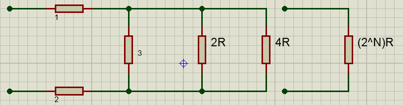

I guess I got the idea of your hint, but I'm not sure if it's correct. So if we only consider the resistance value of the first block (n=0 only) as R, in n=1 circuit (first and second blocks only), we have 2R parallel with the first block (R), so we get something like
And Req = 1/R + 1/2R + 1/4R + ...

Can you show what the series looks like if you use my hint? What is the resistance of each next stage that is in parallel with each vertical resistor...?
Can you say what you got for the approximate final resistance with that method? I'd like to check the answer that I got with an infinite series... :smile:
Well, I see a n*2.4 (n*12/5) in my calculations..
I don't know. Something like ~5.4 (or less)??

All correct answers are equivalent (!) but I converted the network into itself (2x the network attached to the three leftmost resisters is the network again) to get a quadratic equation for the network R value. No explicit series need be evaluated. Whatever works!
  • Love
Likes sysprog, Jody, berkeman and 2 others
Would you explain this part please? Why the other part is 2x the first block network?
It is my favorite trick (really my only trick for series so I use it whenever)
Let the unknown value of the network resistance be R.
II multiply every value in the network by 2 then the value of that network is obviously 2R.
But look at that network...if connect the 1,3 and 2 ohm resistors to the front end I again reproduce the original network. So I know that R=1ohm+2ohm + (3ohm in parallel with 2R)
Gives me a quadratic for R (pardon my Latex-lazy presentation).
Ohhhhhhh, yea.
Thanks. I finally realized.

Tom.G said:
I'll bite. Could you give the quadratic even if not in LaTex.?
2R2-9R-9=0.
