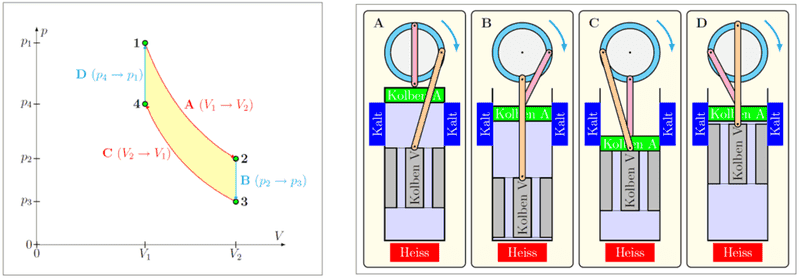

Hi.
In my (German) physics lecture notes, I found this depiction of a Stirling engine:
According to the text, it should be
A: isothermal expansion
B: isochoric cooling
C: isothermal compression
D: isochoric heating
This seems correct for the PV diagram, but strange in the illustration on the right. Shouldn't A and C be (approximately) isochoric since that's where piston A (green) is at dead centre?
