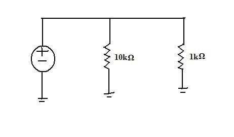

"Estimated" equivalent resistance
Suppose I have a circuit like the one below, how will you "estimated" the equivalent resistance without using calculation?
I know how to calculate equivalent resistance by using Formula: R1 * R2 / (R1+R2) . But can anyone use their logic and estimate the equivalent resistance without using any formulas?
Thank you!
One resistor has 10X the value of the other, so it represents a minor "load" compared to the smaller resistor. So the net resistance should be just a shade under the smaller resistance (by about one tenth).
