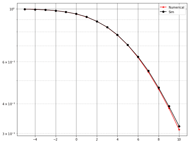

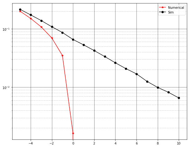

OK, now I put the code together for the actual PDF and CDF of the random variable, and did the numerical and Monte-Carlo simulation for a range of values of ##\gamma##. The code is as follows:
Python:
#************************** Import necessary libraries******************************************
import numpy as np
import math
import matplotlib.pyplot as plt
%matplotlib inline
#******************************Set the constant scalars and vectors***************************
granularity = 700
K = 3
beta_dB = 3
beta = 10**(beta_dB/10)
EF = 100
gammadB = np.arange(-5,11)
gammaVec = 10**(gammadB/10)
N = 100000 # For simulation
#******************************Define functions to be used***************************************
#Define the CDF of U
def F(u):
      return 1-1/(u+1)
#Define the PDF of U
def f(u):
     return 1/((1+u))**2
def G(h, k):
    #print(f'h is {h}, and k is {k}')
    if k == 1:
        res = F(h)
    else:
        du = h/granularity
        res =  0
        u = 0
        while u < h:
            res += G(h-u, k-1)*f(u)*du
            u += du
    return res
#*******************Find the numerical and simulation values of the integral******************
Pout = []
PoutSim = []
for gamma in gammaVec:
    gammath = (gamma/beta)*(EF-beta*(K-1))
    # Numerical
    Pout.append(1-G(gamma, K))
    # Simulation
    count = 0
    for n in range(0, N):
        if np.sum(np.random.exponential(1, (1, K))/np.random.exponential(1, (1, K))) <= gamma:
            count += 1
    PoutSim.append(1-count/N)
#**************************Visualization******************
fig, ax = plt.subplots(figsize = (10, 8))
major_ticks = np.arange(0.1, 1.1, 0.1)
minor_ticks = np.arange(0.1, 1.1, 0.1)ax.set_yticks(major_ticks)
ax.set_yticks(minor_ticks, minor=True)
ax.set_yscale('log')
ax.grid(which='minor', alpha=0.2, linestyle='--', linewidth=1, color='k')
ax.grid(which='major', alpha=0.5, linestyle='-', linewidth=1, color='k')ax.plot(gammadB, Pout, 'r-*', label = 'Numerical')
ax.plot(gammadB, PoutSim, 'k-o', label = 'Sim')
ax.legend()
ax.grid(True)
plt.show()
fig.savefig("test.png", bbox_inches='tight')

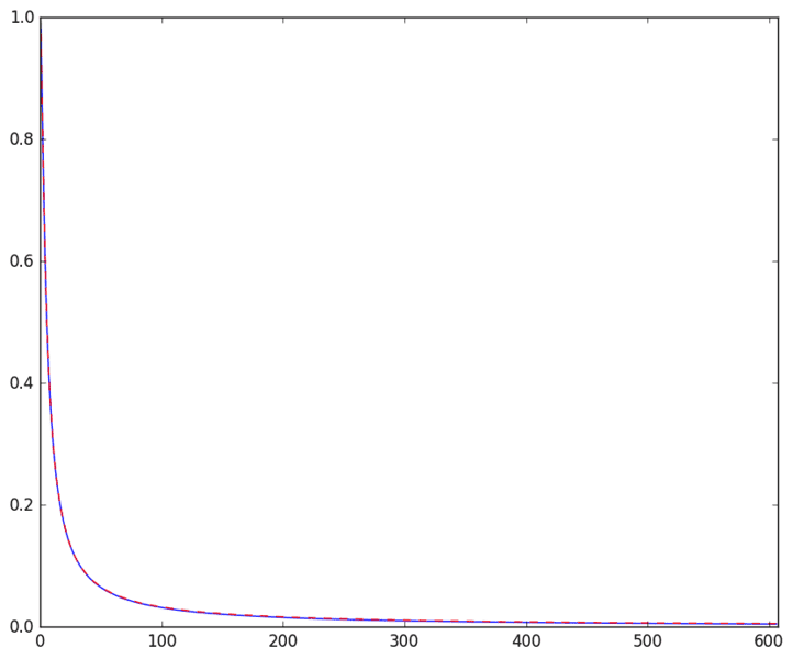

The resulted figure is attached as test.png. It shows that both yield very close curves. Which is good.
What I actually want to do, is to replace gamma, by gammath. The changes will be
Python:
    Pout.append(1-G(gammath, K))
        if np.sum(np.random.exponential(1, (1, K))/np.random.exponential(1, (1, K))) <= gammath:
This resulted in test1.png, which is also attached. Here the curves are very different. Why? The simulation curve makes more sense than the numerical evaluation. This implies that there is something wrong in the numerical implementation of the integral. What is wrong in the numerical implementation?
@EngWiPy You are using a constant relative granularity as your integrating range increases. That means that the size of the integrating increment du gets bigger as the outer limit gamma or gammath gets bigger. Since the overstatement of the simple rectangular approach is proportional to the size of the increments, the integrating error gets larger when you get to very large ranges, as is the case with gammath, which goes to over 600.
You could fix this by setting the granularity to be a fixed absolute, rather than relative, amount. eg set du globally to be 0.01.
Thanks. I am testing it. 0.01 wasn't small enough, so I decreased it to 0.001, and now it is taking too long. I will report back when I have some results.

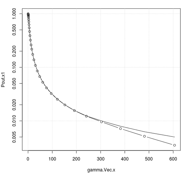

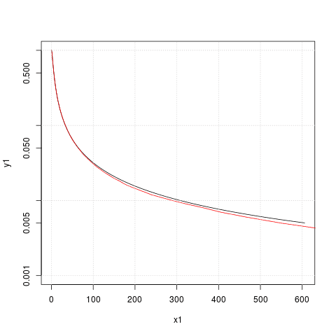

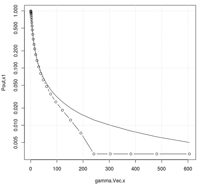

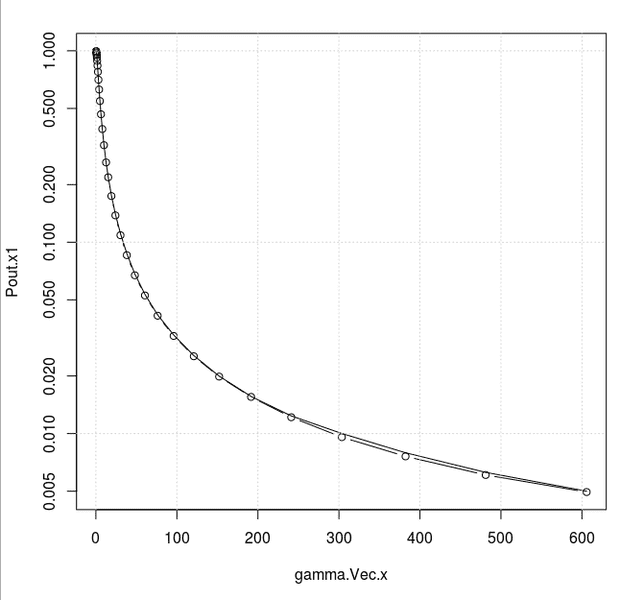

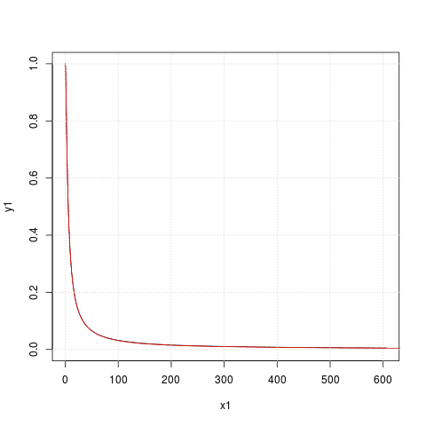

I've done an R implementation (Python turned out to be too painful, with my relative inexperience in that language) below. I used two techniques to improve accuracy:
  1. Setting the integration increment to be inversely proportional to the integrand, with a maximum increment size
  2. Using cubic spline interpolation to reduce errors from nonlinearity
It starts to misbehave when the gamma integration limit is very large, I think because the integrand gets so close to zero, and it gets in a mess if it goes below zero, which can easily happen with a cubic spline interpolation. Putting a floor of zero creates big errors - I don't know why yet, cos I'd expect the errors from that to be negligible. So instead I got it to switch to trapezoidal integration if any of the cubic splines dip below zero.
Attached are the code and three plots. The most accurate used cubic splines with a maximum increment of 3, and took 3.5 mins to run. The next was cubic with max increment of 4, and took 1.5 mins to run. Last is one that used trapezoidal integration, which took 14 secs to run. You can see it loses accuracy for gamma (integration limit) beyond 100, but the probability is already below 3% at that stage. The log scale exaggerates the errors.
I think the key point is that for deeply nested integrals like this, Monte Carlo simulation is actually more accurate for a given runtime than numerical integration. The MC sim runs in a couple of seconds and is much smoother (which I take to be a sign of accuracy.

# now do simulation version
simx <- exp.inv.cdf(runif(K * N)) / exp.inv.cdf(runif(K * N))
dim(simx) <- c(N, K)
PoutSim <- outer(apply(simx, 1, sum), gamma.Vec, "<=")
PoutSim <- 1 - apply(PoutSim, 2, sum) / N
#************************^Visualization****************^
time.end <- Sys.time()
time.gone <- difftime(time.end, time.save, units = "mins")
print(paste('time taken is', time.gone, "minutes"))
plotcurves <- function(gamma.Vec.x, Pout.x, PoutSim.x){
  Pout.x1 <- pmax(Pout.x, min(Pout.x[Pout.x > 0])) # set min of the min positive Pout value
  lims <- rep(max(c(Pout.x1, PoutSim.x)), 2)
  lims[1] <- min(c(Pout.x1, PoutSim.x))
  plot(gamma.Vec.x, Pout.x1, type='b',log="y", ylim = lims)
  lines(gamma.Vec.x, PoutSim.x, type='l')
  grid()
dev.new()
plotcurves(gamma.Vec, Pout, PoutSim)

I tried to implement the accumulation approach as following:
Python:
def G(h, k, u):
    if k == 1:
        res = F(h)
    else:
        #du = h/granularity
        res =  0
        #u = 0
        while u < h:
            res += G(h-u, k-1, u)*f(u)*du
            u += du
    return res
gammadB = np.arange(-5,11,4)# np.array([11]) #
gammathVec = (gammaVec/beta)*(EF-beta*(K-1))
print(gammathVec)
Pout = []
if (EF-beta*(K-1)) > 0:
    for index, gamma in enumerate(gammathVec):
        #For the first value, integrate from zero
        if index == 0:
            Pout.append(G(gamma, K, 0))
        else: #For other values integrate from
                   #gammathVec[index-1] and add the
                    #result from the previous value
            Pout.append(Pout[index - 1] + G(gamma, K,
                                                gammathVec[index-1]))
Pout = 1 - np.array(Pout)
But it doesn't give correct results. Where did I make a mistake?
