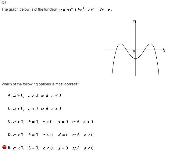

confusedatmath
Can someone explain why the answer is D
a < 0 because it finishes downwards
e < O because the y-intercept is in the negatives.
b, & d = zero (but i don't get this)
c is supposedly > 0 (nor do i get this)
According to the solutions the graph is an even function, and symmetrical about the y-axis/x-axis. I haven't studied this, can someone please explain for values b,d,c.

Looking at the graph, we can see it is reflected across the $y$-axis, meaning it is an even function, which means:
$$y(-x)=y(x)$$
This means the coefficients of the terms having an odd exponent on $x$ must be zero, i.e.:
$$b=d=0$$
This leaves us with:
$$y(x)=ax^4+cx^2+e$$
Now, we see that:
$$y(0)=e<0$$
We also see that as $x\to\pm\infty$ we have $$y(x)\to-\infty$$. This means the dominant term, that is, $ax^4\to-\infty$ which implies $a<0$. But in order to have $y(x)>0$ on the two shown intervals, we must have $0<c$.

Hello, confusedatmath!
We have: .[tex]y \:=\:ax^4 + bx^3 + cx^2 + dx + e[/tex]
The graph is symmetric to the y-axis.
On the right, we have two x-intercepts, [tex]p[/tex] and [tex]q.[/tex]
On the left, we have two x-intercepts, [tex]\text{-}p[/tex] and [tex]\text{-}q.[/tex]
The function has the form:
. . [tex](x-p)(x+p)(x-q)(x+q) \:=\:x^4 - (p^2+q^2)x^2 + p^2q^2[/tex]
Since [tex]a[/tex] is negative, we have:
. . [tex]y \:=\:-\left[x^4-(p^2+q^2)x^2 + p^2q^2\right][/tex]
. . [tex]y \:=\:-x^4 + (p^2+q^2)x^2 - p^2q^2[/tex][tex]\begin{array}{cc}\text{Therefore:} & a\text{ neg.} \\ & b = 0 \\ & c\text{ pos.} \\ & d = 0 \\ & e\text{ neg.} \end{array}[/tex]
wow mindblown. :O that was such a cool way of solving it! THANK YOU (Inlove)
