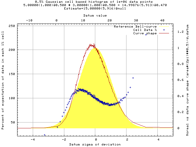

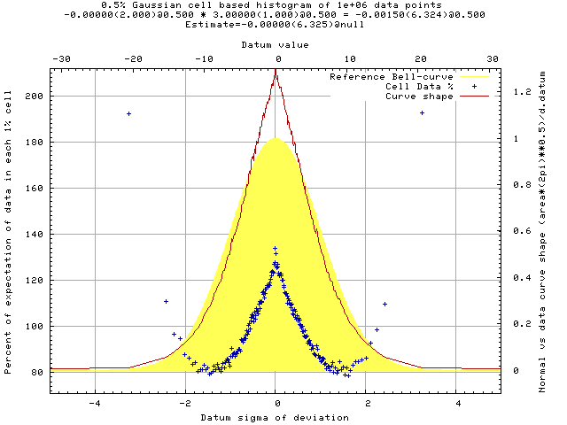

Yes, quite true. However, I am operating only on "assumed" Gaussians reported by someone else; (Thankfully NOT exponenetial!) and the only operations I am performing on it are add subtract multiply and divide. For add and subtract, the operation does a convolution on the data elements making the result "look" more and more Gaussian.
Multiplication for items with σ << μ also happens to look very Gaussian...
However, multiplication and division which don't obey the above relationship introduce serious Kurtosis and increasing skew. (A problem...)

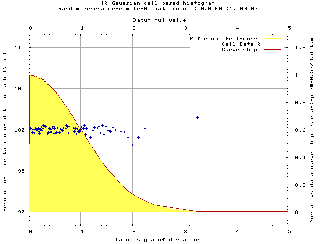

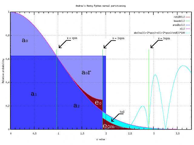

Anyway, I'm not interested in anything so complicated -- I am using a mixture distribution already. Cyhelsky skew gives a relative measure of how much data is above a mean vs. below. That in turn, automatically relates the sigma on each side of the mean (one sided sigmas, don't know the proper name...) to the skew; and they become increasingly different as skew increases; The final result of a simple mixed distribution can trivially be converted to a single sigma Gaussian, which would be the exact same as if the distribution's data points were used without reference to the side of the mean which they were on.
What I did, is use half a bell curve for each side of the mean -- eg: with the sigma set different for each side. That allows the calculator to handle skew in a basic way -- *but* that method does introduce a discontinuity at the mean.
However, this mixed distribution *did* allow me to develop the mathematics to handle adding skewed distributions.
Using the numerical simulations, I have noticed that even the first or second operation (say addition) smears the discontinuity out very much. Eg: the convolution has that effect... which is very desirable.
The mathematics I developed happens to apply quite accurately to subsequent steps, and since each convolution due to addition causes the subsequent result to look *more* Gaussian, the accuracy does not degenerate with more steps (It beats the **** out of what using ONLY pure Gaussians can do.)
The representation is good enough for use right now for addition of Skewed data sets, although I'd like to replace the mixed distribution of half bell curves with one that is equivalent to that mixed distribution after a *single* operation with a true un-skewed Gaussian. The new representation would automatically smear out the discontinuity, and produce curves which more realistically representing typical data sets with tails going to zero, and a single mode.
Since multiplication tends to have almost the same curve (visually) as some of my mixture distributions after a *single* addition, I figure I can use this new mixture distribution as a basis for representing results of multiplications and divisions, internal to the calculator. (The only problem that stops me from finishing the calculator.)
So, all operations, inside the calculator, can be represented by a single data distribution type -- a mixed distribution based on a Cyhelsky skewed Gaussian...
