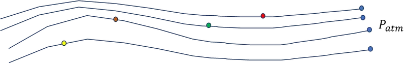

If I choose two arbitrary points above the wing, how will I know if they lie on the same streamline?

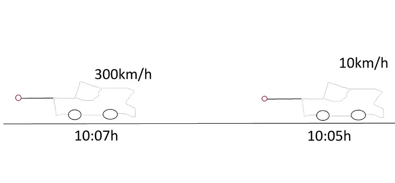

in 10:05h car drive 10km/h in 10:07h car drive 300km/h, at front is probe with static port in clean air.
Why are these two separate situations, why this case is not same as particle flow in pipe from big diameter to small diameter? (except this is atmosphere, not constrain by pipe walls)

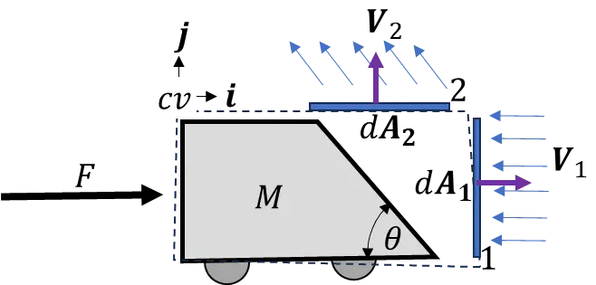

I think it would be helpful if we tried to work off of this problem type I cooked up that attempt to examine the things you ask about in the OP.
Imagine you have a cart like this in still air. It is moving with a constant velocity to the right being propelled by a force ##F##. The control volume is the dashed boundary encasing the cart and the induced flow in the "vicinity" of the cart, where things are obviously changing. The frame labeled ##cv## is inertial. What questions can we help to answer on a model like this (please excuse the drawing)?
Diagram of a cart with a sloped rear face at angle θ, mass M, on two wheels, pushed right by force F, in a control volume (dashed) with air flow: streamlines from V1 at surface 1 (dA1) deflected to V2 at surface 2 (dA2) above.

It is "like" pipe flow in the sense that the molecules bouncing off the cart are constrained by other molecules, which are constrained by more molecules etc... This is what I think anyhow. I don't know how a physicist reconciles this...as I think the pressure is independent of particle collision in an ideal gas. However, in a fluid model it makes perfect sense. So I am also intrigued to explore/discuss there as well.
?? The particles are kilometers apart.
But another answer is that this example is unsteady flow, and Bernoulli's Priinciple assumes steady flow. It's like if you have a fan powered Venturi tube and you are turning up the fan speed while reading different points in the tube. The readings will not satisfy Bernoulli's Principle/ conservation of energy because the mass flow rate at the first point will be higher. than at the second point.

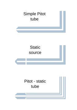

If we have case where air blower blow air in atmosphere. If I increase power of blower in time interval A to B, from 10% to 100%, airflow is accelerated in this time interval, so there is positive pressure gradient in flow direction.
(Here we can't use Bernoulli, because it is unsteady flow.)
If I put pitot-static tube in front of air nozzle, what will static port show in this time interval?
I don’t understand your scenario and what interval you mean. You need a steady flow in an inertial reference frame.
Yes I know, but I do unsteady flow deliberately , here airflow speed increase during measurement. Will static port read lower pressure that atmospheric pressure?

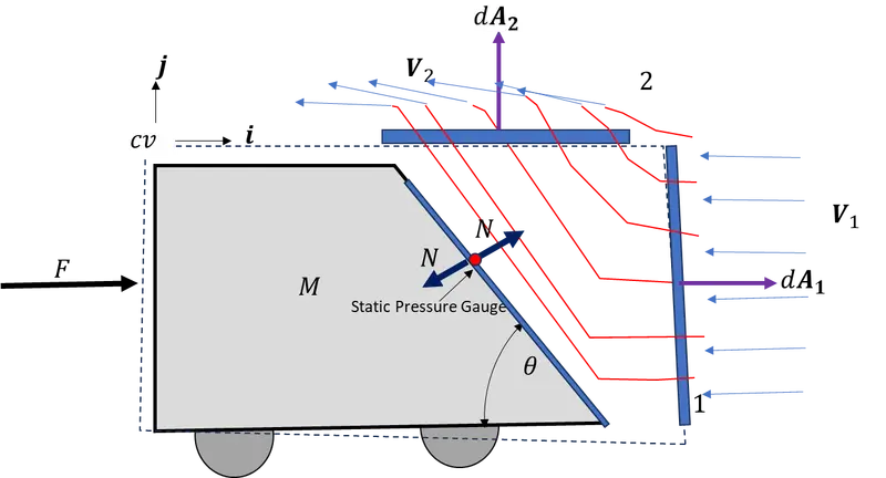

My intuition is that the static pressure would be higher than atmospheric in the impact zone(front of the vehicle). What is your opinion, or anyone?
If the car is sitting still in still air, atmospheric pressure registers on the gauge. If it starts forward motion a normal force develops on the car, that normal force is also acting on the flow via Newtons Third Law. I expect that normal force distributes over the front to the wedge in addition to atmospheric pressure.
Free-body diagram of a wedge-shaped vehicle of mass M with a force F on its left, a sloped face marked with a static pressure gauge and normal forces N, and a control volume with inlet flow V1 and outlet flow V2 with area vectors dA1 and dA2.
$$ P_{gauge} \approx P_{atm} + \frac{N \sin \theta }{A_1} $$
In my test there is no impact zone.
In your test from post #45, yes some distance in front of car is higher pressure than atmospheric. The highest pressure is at stagnation point.
