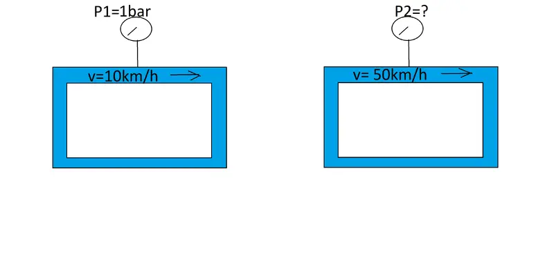

  • #62
user079622 said:
Bernulli cant apply here(faster speed = lower static pressure)
Is this correct and why here pressure dont drop with speed(as Bernoulli state)?
The Bernoulli principle says that, in the absence of external forces on the fluid,
$$\frac{v^2}{2}+\frac{p}{\rho}={\rm constant}$$
along a streamline. But the "constant" is not a universal constant, it depends on the streamline.
What happens with this equation when you go from Galilean frame of reference to another? The ##\rho## and ##p## do not change, they are invariant. The ##v## changes. This is consistent with the Bernoulli principle because the constant changes as well. In other words, the Bernoulli principle still applies, but in this case faster speed implies larger constant, not lower pressure.
This change of ##v## due to change of the Galilean frame of reference should be distinguished from the more common change of ##v## due to change of geometry (such as width of the pipe or shape of the wing). In the latter case the constant is the same along the streamline, so the change of ##v## is accompanied with the change of ##p##.

  • #66
A.T. said:
You can have accelerated steady flow, where Bernoulli still applies. So it's not clear why you introduce unsteady flow, in a thread about Bernoulli.
Did you mean "can't"?

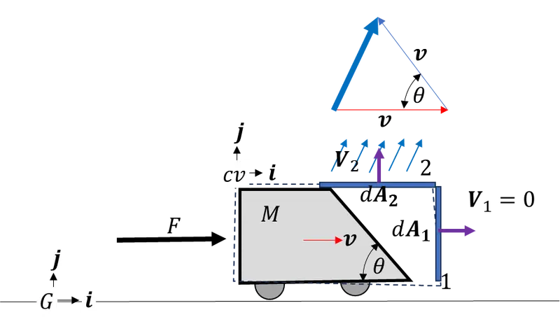

  • #67
No, I think they are correct. You can have accelerated steady flow. The molecules entering a convergent section are accelerating, its non uniform flow, but still steady ( not time varying, but spatially varying ).

  • #70
On a pathline we have:
$$ \boldsymbol{a} = \frac{d \boldsymbol{V} }{dt} = \frac{d}{dt} V(s,t) \boldsymbol{u_t} + V(s,t) \frac{d}{dt}\boldsymbol{u_t} $$
$$ \boldsymbol{a} = \frac{d \boldsymbol{V} }{dt} = \left( \frac{\partial V}{\partial s} \frac{ds}{dt} + \frac{\partial V}{\partial t} \right)\boldsymbol{u_t} + \frac{V^2}{r}\boldsymbol{u_n} $$
In the Bernoulli derivation along a streamline the tangential component is the relevant bit, and the flow is assumed steady.
This is Euler Equation which arises from a force balance:
$$ -\frac{\partial }{ \partial s} \left( p + \rho g z \right) = \rho V \frac{\partial V }{\partial s} $$
They can all become normal derivatives, since everything just depends on ##s##:

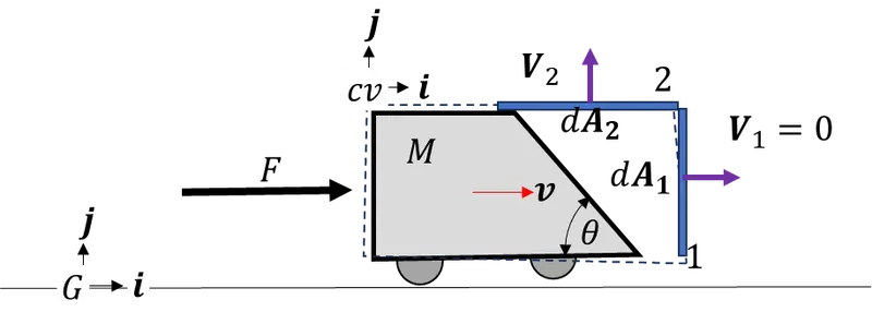

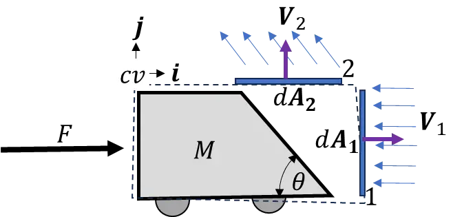

with ## V \frac{dV}{ds} = \rho \frac{d}{ds}\left( \frac{V^2}{2}\right) ##
you get:
$$ \frac{d}{ds} \left( p + \rho g z + \rho \frac{V^2}{2} \right) = 0 $$
$$ \implies p + \rho g z + \frac{V^2}{2} = C $$
So in Bernoulli's we apply in instances without temporal variation at a location, rotation, viscous, and compressibility effects.

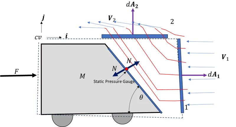

  • #71
Arjan82 said:
So, now take external flow. I.e. the flow around a car or airplane or whatever. As long as it is not somehow confined. Also, take a case for which Bernoulli applies and remember what I said: adding energy to the flow causes Bernoulli to not be valid anymore. How do you accelerate external flow without adding energy to it?!? Think about it...
So in the case where there is still air and a force pushing a car through it at constant velocity, energy is being added to generate the flow. Is it fundamentally different if that force were instead a restraining force and a flow was passing over the still cart? I'm asking in reference to post 45, and post 58. Where I'm trying to analyze the OP's problem.
  • #72
Arjan82 said:
So the statement "accelerating flow leads to lower pressure" is misleading and certainly not true in general. Take a fire hose which is open at one end (no nozzle). The pressure at the end (where the water flows into the open atmosphere) is very close to atmospheric pressure. Ok, now add a nozzle at the end. This constricts the outflow area and usually greatly increases the flow velocity. Is the pressure at the nozzle exit now lower? Nope... it is still about atmospheric pressure.

  • #81
That depends on your frame of reference. You can say there is no energy added if you attach your frame of reference to the car. So from the car's perspective there is no energy added and Bernoulli can be applied.
If you fix your reference frame to the road (to earth) the car indeed adds energy to the system and you cannot use (unsteady) Bernoulli.
Energy is frame dependent, yes.

  • #85
In 45 and 58 the frame is the cart, and its inertial. The air is still in the ground frame, the cart is moving with constant velocity ##v=V_1## to the right. Bernoulli's applied for the velocity of the flow yields ##V_1 = V_2## along any of those streamlines. Pressure is also constant along a streamline, and is initially atmospheric on all the streamlines. Therein lies the problem, because I think the pressure at a streamline near the "hood" is actually more like:
$$ P_{gauge} \approx P_{atm} + \frac{N \sin \theta}{ A_1} $$
If I do the problem in the way I was "taught" using conservation of mass, momentum, and energy and some uniformly distributed flow velocities with the equations:
$$ 0 = \frac{ d}{dt} \int_{cv} \rho d V\llap{-} + \int_{cs} \rho ( \boldsymbol {V}\cdot d \boldsymbol{A} ) $$
$$ \sum \boldsymbol{F} = \frac{ d}{dt} \int_{cv} \rho \boldsymbol{v} d V\llap{-} + \int_{cs} \boldsymbol{v}\rho ( \boldsymbol {V}\cdot d \boldsymbol{A} ) $$
$$ \dot Q - \dot W_s = \frac{d}{dt} \int_{cv} \rho \left( \frac{V^2}{2} + gz + u \right) d V\llap{-} + \int_{cs} \left( \frac{V^2}{2} + gz + u + \frac{p}{\rho} \right) \rho \boldsymbol {V}\cdot d \boldsymbol{A} $$
I don't seem to find that result? This is I think what the OP is after (as far as I can tell) "What a static gauge reads on the front face of the cart". The apparent contradiction gives me pause in my understanding of a typical simplified analysis of this problem.

@user079622
Are you trying to figure out what the gauge I have shown ( post 85) reads when the cart is traveling to the right with constant speed ##V_1## as a function of ##V_1## like I think, or am I mistaken and you are really concerned with what it reads while the cart is explicitly accelerating? If it's the latter I'll tap out, because I think what it reads when the cart is just moving with constant velocity is challenging as it is (and would be enlightening regardless), and a place to try and make some forward progress with structured analysis.
  • #89
erobz said:
Are you trying to figure out what the gauge I have shown ( post 85) reads when the cart is traveling to the right with constant speed ##V_1## as a function of ##V_1## like I think, or am I mistaken?

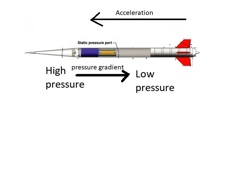

No. Topic is explanation of reduction in static pressure (const. density/temp.) at molecular level. Physicall reason. I should have named title differently, because topic turn into Bernoulli.
Your static port at post #85 will show higher pressure than atmospheric, pressure will be higher as speed increase. If you installed your static port at probe 3m in front of car, in clean air/freestream, it will show atmospheric pressure at any constant speed.
I am not sure what will static port(probe 3m in front) read, when car accelerate, because now we have pressure gradient in direction of flow.
  • #90
If by ##V_1## you mean 'the free and undisturbed flow in front of the car' and with ##V_2## 'the free and undisturbed flow downstream of the car' than you are correct to say ##V_1 = V_2##, but anywhere between this does not need to be true..
Also, if the pressure is constant along a streamline and is initially atmospheric, then it is atmospheric everywhere right? However, in streamlines that go around the care the pressure is not constant, nor atmospheric. Also, the velocity is not equal to ##V_1##. Why do you think it is?
Funnily enough this is what Newton used to predict lift forces of a wing, it is not correct. But conceptually it is correct that the static pressure increases at the red dot which is correlated with the angle of the surface at that location.
This is indeed conservation of mass and momentum. You can use those to derive Bernoulli. You don't need conservation of energy as well. But you can also use conservation of energy and mass to derive Bernoulli. Both will work.
Well that's not trivial at all. So there are some analytical solutions of the flow equations (with lots and lots of simplifications), like the Joukowsky transform. Those solutions will tell you what the static pressure and velocity is at a certain location. But that does not follow from Bernoulli.
