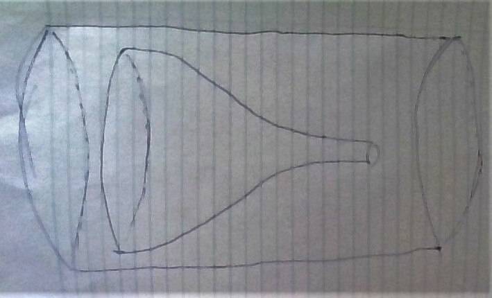

Grey Area said:
Similarly, I wondered if running a narrow diameter pipe down a main pipe would cause faster flow at the centre, which when the flows rejoin, would cause material in the "outer flow" to gravitate towards the area of lower pressure at it's core - which could be used to prevent "spread" of the whole stream...
Say the fluid starts by flowing through the large-diameter pipe. Then, at some distance there is a small-diameter pipe within the large-diameter pipe. Then, at some distance after that, the small-diameter pipe ends, rejoining the flow. I don't see why the flow through the small-diameter pipe would be substantially faster. There's no substantial contraction in flow. The area is less through the small-diameter pipe, but so is the discharge, so the velocity shouldn't change substantially.
(Due to viscosity, the fluid in the center would be somewhat faster than the fluid at the edge, but I don't think this is what you're talking about, and this isn't about the small pipe).

If the small-diameter pipe decreased in diameter along its length, while the large-diameter pipe did not change in diameter, the fluid in the small pipe should speed up, while the fluid in the large pipe should slow down. If the flows were then rejoined, this might, although I really am not sure, decrease the pressure near the center of flow. (I included a sketch of what this might look like).
I'm not sure if I should be responding to this though, because I definitely don't have any authority on this topic, and I'm sure you will get much better responses here.

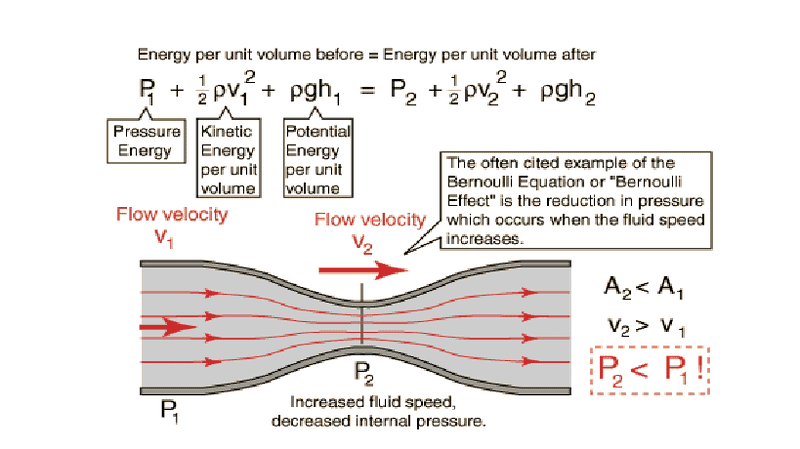

this is the image I associate with the Benoulli Effect (not principle, perhaps that is part of the confusion;
My interest is, how does this effect apply when there is more than one restriction;

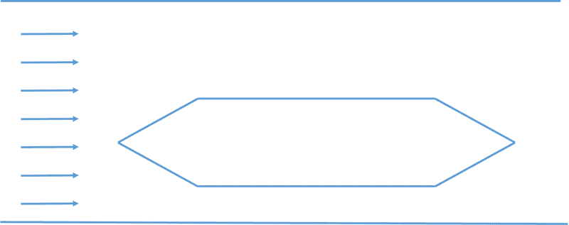

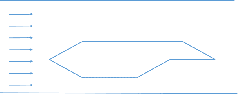

Sorry - should have coloured in the lozenge - basically the large pipe diverts either side of it, so the overall flow is reduced, but also the pipes are of unequal CX area
And further...if the restrictions are of different lengths?
In this case the lower restriction broadens out before the upper one.
Hope that explains!
The velocity increases with a decrease in cross-sectional area. That relates to conservation of matter.
The pressure decreases with an increase in velocity. That relates to Bernoulli's Principle.
What do you think would happen in those two setups?
Bernoulli applies to inviscid flows. No friction. Accordingly, the restrictions can be of arbitrary length.
If there is friction then there must be a pressure drop over distance. For long, straight tubing with laminar flow, Poisueille's law can quantify this.

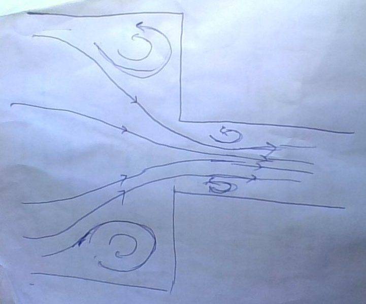

That helps (If I'm right) but doesn't answer my real-world question...how instantaneous is the change? If instead of the gradual restriction, a pipe went immediately from a 1m diamater to a half meter diameter, is the flow and pressure change literally immediate?
Similar to what jbriggs said, I think it would be complicated. The fluid flow would, I think, look roughly like this sketch. Exactly how the pressure changes, I don't know. I don't see how it could drop instantaneously, though.

Bernoulli is only an energy conversion equation, need the Energy equation with friction and other irreversible processes.
The transition for flow leaving the smaller pipe suddenly at its end in the larger pipe is gradual over a distance from the small pipe end and it depends on diameters, flows and velocities. The jet from the smaller pipe has to expand to the larger pipe area with decay turbulence to eventually merge with the flow outside the smaller pipe to a lower pressure (actually lower total velocity head + pressure head + elevation) downstream from the smaller pipe exit . Same applies for many smaller pipes in the larger pipe, just more complicated flows patterns.
