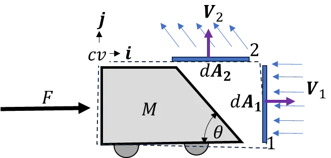

I can't solve for what the force ##F## is equivalent to, without some invocation/simplification of the First Law - Bernoulli's? I used all three equations. I get this:
$$F = \rho V_1^2 A \sin \theta ( 1 + \cos \theta - \sin \theta ) $$
EDIT: I was trying to derive that in the ground frame before, I probably messed up. Also, I assumed hastily ##A_1 = A_2##.
Just to be clear this was the simplification:
Summary of the solution ( assuming uniform velocity distributions remove integrations - steady flow - incompressible flow):
Mass Continuity:
$$ 0 = ( \boldsymbol {V_1} \cdot d \boldsymbol {A_1} ) + ( \boldsymbol {V_2} \cdot d \boldsymbol {A_2} )$$
$$ \implies A_2 = \frac{V_1}{V_2} \frac{A_1}{\sin \theta} \tag{1}$$
Momentum in the horizontal direction ( the frame is inertial - all velocities in equations now referenced from frame ##cv## traveling with cart ):
$$ \boldsymbol {F} = \rho \left[ \boldsymbol {V_1} ( \boldsymbol {V_1} \cdot d \boldsymbol {A_1} ) + \boldsymbol {V_2} ( \boldsymbol {V_2} \cdot d \boldsymbol {A_2} ) \right] $$
$$ F \boldsymbol {i} = \rho \left[ -V_1\boldsymbol {i} ( -V_1\boldsymbol {i} \cdot 1 \boldsymbol {i} ) + \langle -V_2 \cos \theta \boldsymbol {i} + V_2 \sin \theta \boldsymbol {j} \rangle ( \langle -V_2 \cos \theta \boldsymbol {i} + V_2 \sin \theta \boldsymbol {j} \rangle \cdot \langle 0 \boldsymbol {i} + 1 \boldsymbol {j} \rangle) \right] $$
$$F = \rho \left[ V_1^2 A_1 - V_2^2 \cos \theta \sin \theta A_2\right] \tag{2}$$
And Bernoulli's a reduction of the Energy Equation:
$$ \frac{P_1}{\rho g } + \frac{V_1^2}{2g} = \frac{P_2}{\rho g } + \frac{V_2^2}{2g} $$
$$ \implies V_1 = V_2 \tag{3}$$
Combining (1),(2), and (3) results in:
$$ F = \rho V_1^2 A_1 ( 1 - \cos \theta ) $$
so as a "Drag Coefficient" in ## \frac{1}{2} \rho A C_d V^2 ##
$$C_d = 2 ( 1-\cos\theta )$$
So anyhow, I know its a gross simplification but text list the drag coefficient of a cube ( suspended in flow ) as 1.10. At a right angle ##\theta## this gives 2 since in the textbook flow is over entire surface. I'm sure its vastly to simple but at least it was fun trying.
The factors involving ##\theta## at the end acts like a drag coefficient, with some respectability (as far as I can tell)?

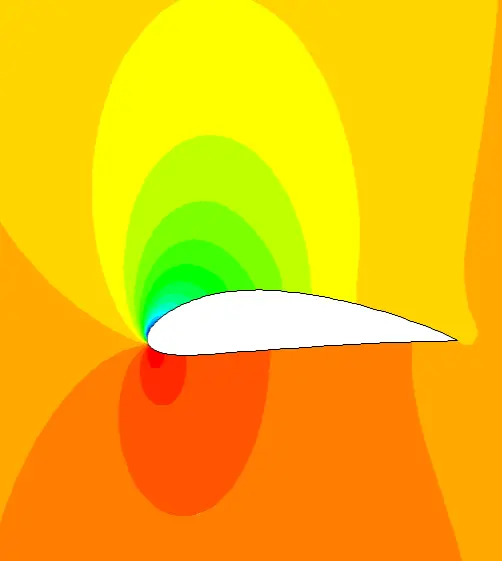

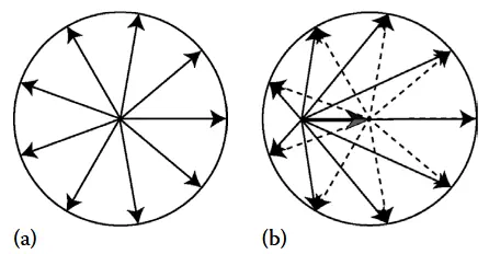

  • #98
user079622 said:
What is difference for molecules if they travel at const. 200km/h over static port of aircraft during flight and molecules that travel const. 200km/h over static port in Bernoulli narrow section. In both case streamlined are flat, not curved.
Why at plane not reduce pressure and in narrow section does, that is what make people confused.
There is no difference. The question is what pressure you are comparing to. You can definitely design a Venturi where at the constriction the pressure is atmospheric. It can even be higher than atmospheric. The only thing Bernoulli says is that the pressure at the constriction is lower than before the constriction. Before the constriction velocity is lower and thus pressure is higher.
In front of the air plane the static pressure is atmospheric (let's say it flies really really low...) and the velocity is equal to the airplane's velocity, really really far in front of the air plane the pressure is still atmospheric and the velocity is still equal to the airplane's velocity (because you are, and should be, still in the frame of reference of the moving airplane).

  • #99
So overall molecules hits / exerted "force" at the surface of ports is same for both case?
  • #101
user079622 said:

@A.T.
@jbriggs444
@Frabjous
Explanation in video from post #61 tell that larger component of velocity parallel to pipe(flow ), reduce perpendicular component of velocity to pipe(static pressure).
This explanation leads to conclusion, that molecules that travel faster parallel to surface(flow),always has lower static pressure then molecules that travel slower or they are at rest.
We know that is not always the case, it is only case for some specific situation, this fact automatically refutes this explanation.
I consider this explanation wrong and misleading, it will only create additional confusion at velocity-pressure related problems and leads to hasty conclusions what I call the "velocity = low pressure misinterpretation" .
Do you agree with me?
If not, explain why.
This explanation leads to conclusion, that molecules that travel faster parallel to surface(flow), always has lower static pressure then molecules that travel slower or they are at rest.
I've underlined the error in your reasoning. Nowhere in the video it is said this is generally true, it is specifically explaining a Venturi nozzle. In other words, you are generalizing their statements up to a point that these statements are not valid anymore. This is your generalization, not theirs.
Already in my first post (#69) I explained why there is no direct relation between velocity and absolute static pressure (what is 'low pressure'? Low compared to what?). Only a velocity difference that leads to a pressure difference. This tells you nothing about the absolute static pressure.
I think the reasoning in the video is based on the kinetic theory of gases, which is strictly speaking not valid for liquids (because it assumes essentially a large mean free path length compared to the particle size), but I think the reasoning holds well enough, conceptually at least. In this condition you essentially have the random motion of particles (responsible for static pressure, and also temperature actually) and their bulk motion (the velocity of the flow). In a Venturi nozzle essentially the random motion is converted to bulk motion. I may have cut some corners here, but I think this is the essence of it.
But note that in general it is perfectly well possible to have different bulk motions (different flow speeds) with equal random motion (equal pressure / temperature) of the particles. Actually, all combinations of bulk motion and random motion is possible (within reason, of course...).
