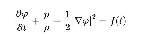

I can save you a lot of trouble. Look again at this equation:
You can easily rewrite this equation to be expressed as an expression for the static pressure:
p = \rho \left(f(t) - \frac{\partial \phi}{\partial t} - \frac{1}{2}\left|\nabla \phi\right|^2 \right)
If you assume acceleration (and since this equation is derived for an inertial frame of reference, we are talking about a cart that is actually moving with respect to the frame of reference), then ##\partial\phi / \partial t## is not zero.
But if you assume acceleration is zero, then ##\partial \phi / \partial t = 0##. Since you want to compare the time instance that velocity is equal for both the non-accelerating and accelerating case, that means that ##\nabla \phi## is equal for both cases. Therefore, the static pressure ##p## must change.
So, whatever you come up with, it has to agree with this analysis.
I'm sure you are correct, but my objective ( finding the force acting againt ##F##) is I believe currently adjacent to finding the static pressure.
Also, the notation is too compact for me to get any sense of. I only have a single reference textbook to work with and they don't have much of anything about the Navier Stokes Equations, other than some derivations from the equations they expect an engineer to work with at low level, namely these forms.
