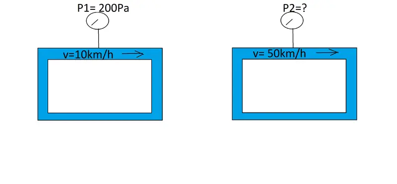

quote from video from post #61 :
"Atoms inside narrow section have smaller component of perpendicular velocity to the pipe and larger component of their parallel velocity to the pipe. Hence the atoms in narrow section will exert smaller pressure on the walls , but will have larger flow velocity."
If you apply this rule to this case below: constant cross section, P1=200Pa, flow velocity= 10km/h and then just increase velocity to 50km/h and ask how much is P2.(where Bernoulli is not valid, because flow is unsteady) you will automatically conclude that P2 will be smaller then P1, because "atoms have smaller component of perpendicular velocity and larger component of their parallel velocity over surface of static pressure manometer".
If their explanation for reduction in pressure is really physically correct, then P2 must be smaller then P1. But of course this is not a case.
Correct answer is P1=P2, and this is proof that their "components velocity" explanation is not "reason" for reduction in pressure, it is not physically correct.

user079622 said:
Focus only for their molecular explanation for reduction in pressure, not Bernoulli law.
But this is exactly what you are not allowed to do with this explanation. The explanation is about Bernoulli's law, not about pressure in general...
But they explanation is at fundamental level, atoms, physical explanation of pressure at atoms level must be general and usable in all cases. Must be consistent in all cases
If fail at even one case, it is wrong. That's my guiding principle.
Arjan82 said:
If you read "Atoms inside the narrow section have a smaller component of perpendicular velocity" than you have to ask yourself: "smaller than what?" The answer is of course "smaller than in the wide section". This means it is a comparison between two locations of the same flow. You cannot extend this explanation to two unrelated cases...
Of course you can't extend this explanation to two unrelated cases , because explanation is incorrect, so it doesn't "work" in general.

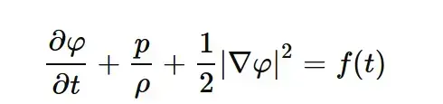

Arjan82 said:
It will still show the pressure equal to the surroundings.
Yes that seems logic to me. Is it mathematically justified?
Equation: ∂φ/∂t + p/ρ + ½|∇φ|² = f(t), the unsteady Bernoulli equation for potential flow, with φ the velocity potential, p pressure, ρ density.

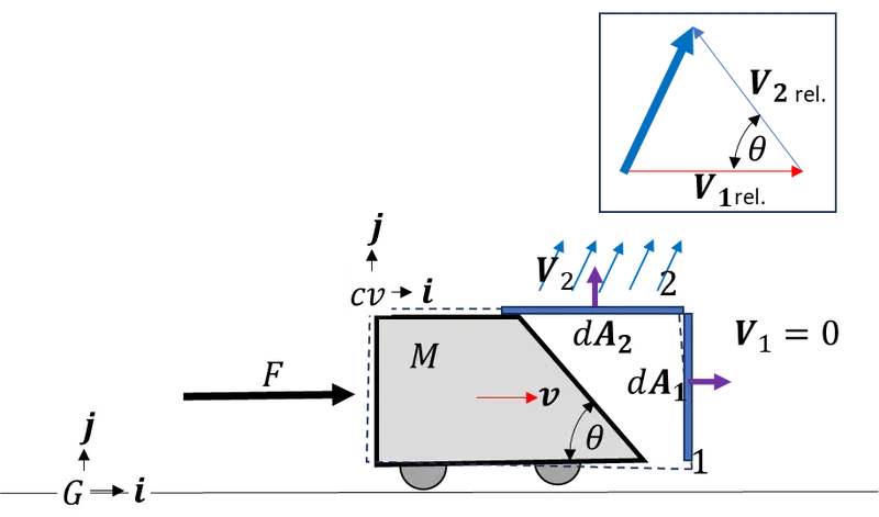

Arjan82 said:
But in the second case, a rocket accelerating through the air, it is not the air that is accelerating but your frame of reference (and the rocket of course). For this case no pressure gradient needs to exist in the air to facilitate the acceleration. This is because the air is not accelerating with respect to an inertial frame of reference.
So if the cart here is accelerating to the right in still air, the force from the "airflow" on the cart at a particular instant is not different than the force from the air on a cart as if it were moving at a constant velocity? Here the purple arrows are area Normals, not velocity.
I don't know what a simplified velocity ##V_2## looks like in this frame... can it actually be parallel to the slope in the cart frame?
Diagram of a cart of mass M with a sloped rear face, pushed right by force F over the ground, with control volume boundary, labelled areas dA1 and dA2, velocities V1 = 0 and V2, and axes i and j.
For me its challenging not to see it as this in the cart frame:
Control volume diagram of a wedge-shaped cart of mass M pushed by force F, with airflow arrows entering at surface 1 with velocity V1 and leaving at surface 2 with velocity V2, and area normals dA1 and dA2 marked.
And infer it must be this in the inertial frame ##G##:
Diagram of a wedge-shaped cart of mass M on wheels, pushed by force F to the right, with its slanted face at angle θ and a control surface outlined by dashed lines. Labels include frame G with unit vectors i and j, cv, velocity v, V1 = 0 and V2, and vectors dA1 and dA2, with a velocity triangle showing v at angle θ.
The problem is that I get different forces ( from the airflow - opposing ##F##) for the two scenarios, and I think it's because I'm cheating (inadvertently) too much with the Energy Equation, or everything I'm doing is a blunder.

Is static pressure:
a) for both speeds same as atmospheric pressure
b) for both speeds lower than atmospheric pressure, and lower at 300km/h than at 10km/h
As posted by others, a) is the correct answer, the static pressure | energy remains constant, while kinetic energy increases. This would be easier to visualize in a wind tunnel, where the car is placed at a point in the tunnel where static pressure | energy is constant. Assuming a propeller is driving the air, more kinetic energy is added when accelerating the air to 300 km/h than when accelerating air to 10 km/h, so the air at 300 km/h has more kinetic energy than the air at 10 km/h, but the static pressure | energy remains constant. The total energy is the sum of kinetic and static related energies, so the air has more energy at 300 km/h than at 10 km/h, while static pressure | energy remains constant.
In case you're wondering about wings, Bernoulli is violated since a wing increases the energy of the air from the air's frame of reference or it decreases the energy of the air from the wing's frame of reference.
Using the air as a frame of reference is easier to visualize with a propeller (assume zero initial air velocity, a propeller that is spinning, but not advancing through the air). The work down by a propeller mostly occurs as a pressure jump as the air flows through the disc swept out by the propeller. The velocity of the affected air when its pressure returns to ambient is called the exit velocity, and reflects the work performed by the propeller.
