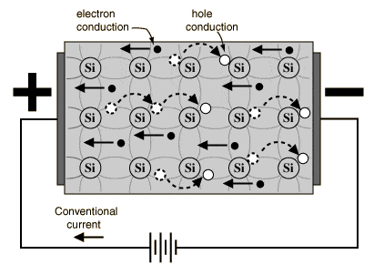

Actually, in an Intrinsic Semiconductor, both electrons and the holes (absent of electron) contribute to the current.

True, but "holes" don't conduct electricity because of the movement of protons.

True but the OPs thread title is Positive charge. I figured a little extra knowledge would be good.

Whilst they can be considered as 'existing' holes are a very sophisticated concept and will tend to add confusion to someone who clearly regards the motion of the electrons in a wire as a consideration in electrical theory.

'Chemistry' is what is used when they actually do the doping but I don't know whether the definition of a 'reaction' is strictly 'producing a new substance' or not. The etymology is hardly relevant here. Whilst a semiconductor is actually operating, I would not say there is a reaction taking place. Nor is there any movement of positively charged real particles. The 'shuffling' of electrons from one positive site to another can be very much like a positive particle moving about in the semiconductor - which is where the notion of holes comes in. You can treat holes in many ways like positive charges moving around but this much be treated with care and no positive charges flow into the terminals of a semiconductor device from the connecting wires!
