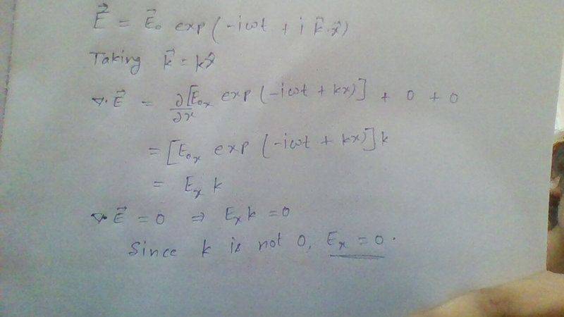

vanhees71 said:
Now using the first two equations you get
⃗k⋅⃗E0=⃗k⋅⃗B0=0.​
\vec{k} \cdot \vec{E}_0=\vec{k} \cdot \vec{B}_0=0.
Thank you, Vanhees 71.
What is meant by c.c. and HL units?
Dale said:
Because then it wouldn't be a wave.
Now, I got Dale's argument, too.
If Ex is not 0, then k has to be zero and k being 0 means there is no wave.
Thank you, Dale,too.This is true for plane wave.
