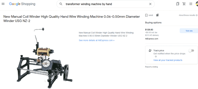

At the start of this thread, I'd assumed that there was a reason that you wanted to wind this magnetic component on a toroid, but now I have doubts. We use toroids in our communication transformers to minimize the volume of those components. The other common reason is to minimize the amount of stray B-field noise that the component generates that can cause problems with other nearby mangnetic components. (But not for the B-field noise immunity of the toroid itself, unless the coil(s) on the toroid are wound a particular way -- Quiz Question: What way?)
Why are you wanting to use the most difficult magnetic component geometry to wind in your application? There are other ways to minimize B-field noise coupling while still using standard bobbin-based winding methods. And if you can use a more standard construction (pot-core, EE-core, EI-core, etc.), you can buy and use a simple hand-driven coil winding machine to give you beautifully consistent winds every time...
https://www.google.com/shopping/pro...&ved=0ahUKEwj26fey8uL4AhUvAjQIHfxaAtkQ9pwGCAU
