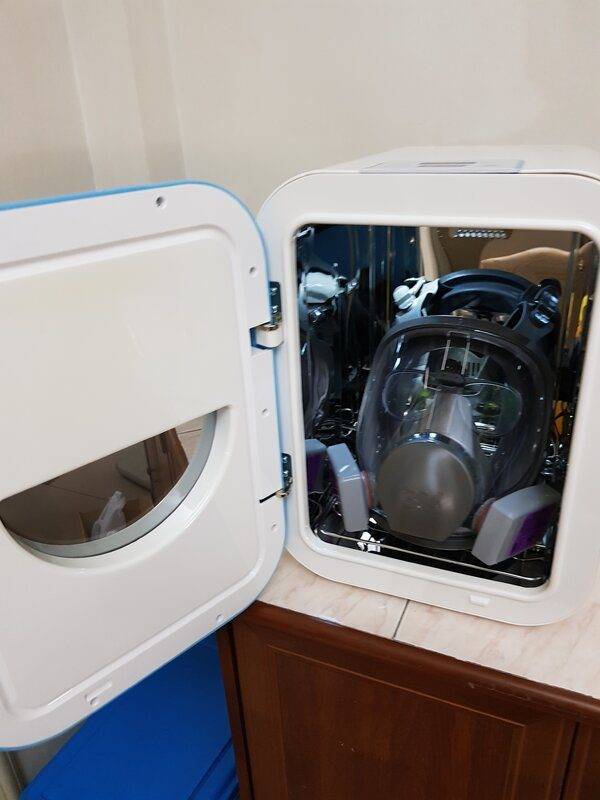

Both chlorine and UV light tend to trash organic materials.
If it was mine, and for some reason I was afraid to read the owner's manual, I'd stick with soap/water - plain old laundry soap is pretty good, with the caveat that it doesn't contain the (re)moisturizers that hand-soap does.

What organic materials exist in non living matter?
The rubber on the facemask, for instance.
3M seems to authorize it. I saw the link at comments in
"Possible disinfection methods: • Sodium hypochlorite solution (at a free chlorine concentration of 5,000 ppm) with 1-minute contact time • 70% Isopropanol solution with 1-minute contact time"
